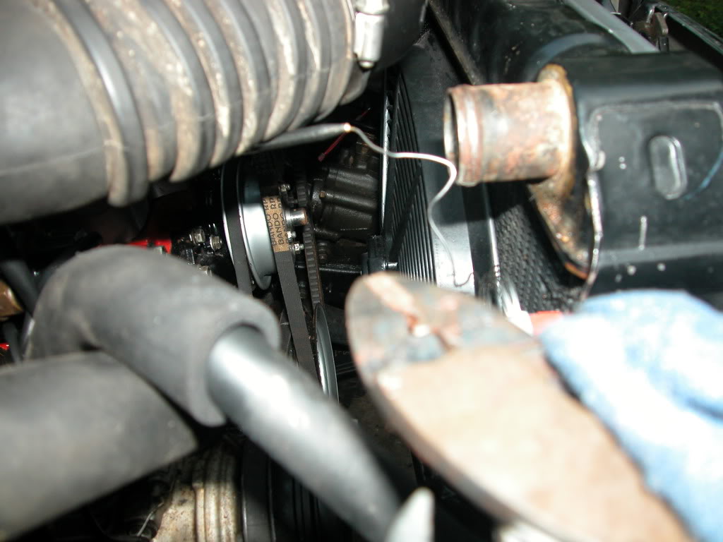

This is the temp sensor and it slides into the water hose just put it in and slide the hose on to the radiator just keep the probe line from hitting the radiator metal really easy to install even though it sounds complicated.

are your sure that's not the probe type that pushes in between the fins in the radiator?
I had the same controller on my dual fan setup in my 82 Monte Carlo that I build a mean 4bm 350 for, and it called for the probe to be pushed into the fins of the radiator
Old Aug 21, 2009 | 01:36 PM
olharleyman's Avatar
Joined: Dec 2006
Posts: 3,607
From: maryland
YEP did it per instructions
