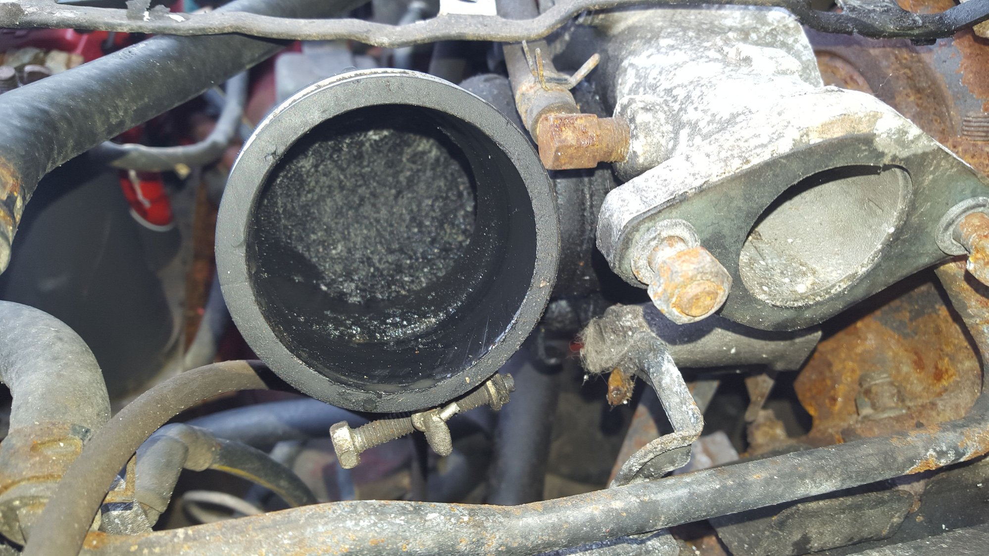

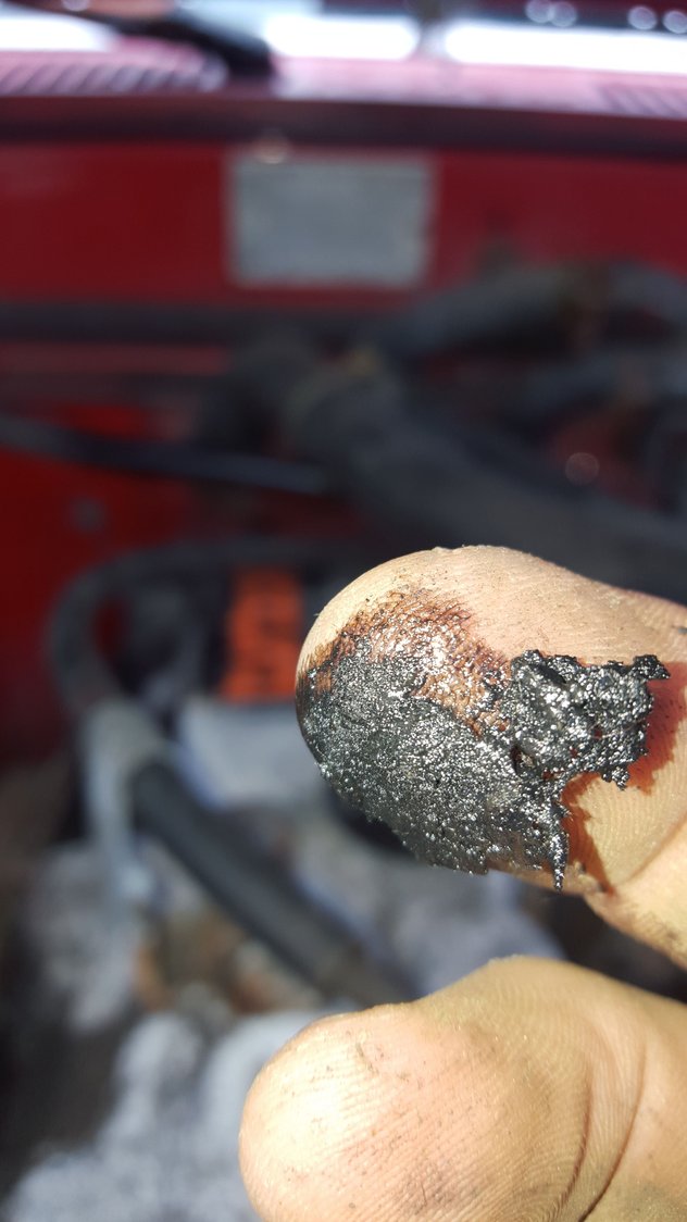

This is a good sign. I'm fairly positive that the Turbo oil seals have failed, and
Are the cause of the runaway.
Thats a lot of oily gunk from the turbo air discharge line.
eyebrows
