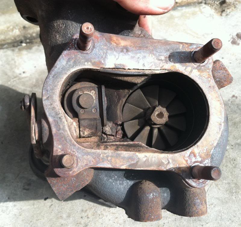

A few months ago I installed a manual boost controller on my truck but no matter what I did it wouldn't boost more than 5PSI. I pulled the my turbo to find that it was cracked near my waste gate and that my turbo needed to be replaced.
The truck only had 128,000 miles! It's a common issues with these turbos, I was just hoping it wouldn't happen in only 128,000 miles. That's when I decided to swap in a CT26 turbo, mostly because it appears stock and I still have to pass California smog tests!

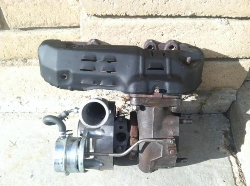

Ok, onto the swap! Firstly here are the two turbos side by side. The stock CT20 on the left and new rebuilt CT26 on the right!

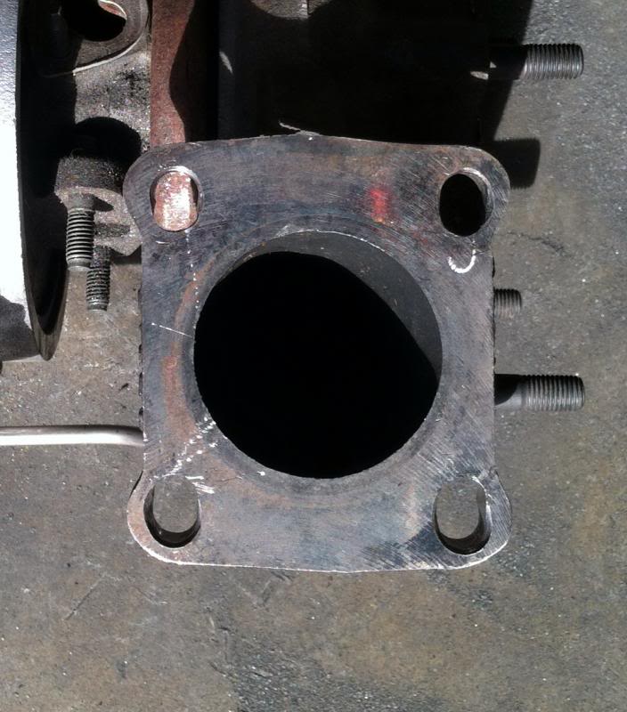

Turbo: The first order of business was getting the CT26 to bolt up to my factory turbo manifold. To this I bought a cheap harbor freight air die grinder with five grinding stone bits, which costs me a grand total of $10. If you don't have an air compressor you could use an electric die grinder also. I probably wouldn't use a dremel though since it seemed to take forever with the air die grinder! Here's a shot of my CT26's mounting flange after I opened up the mounting holes.

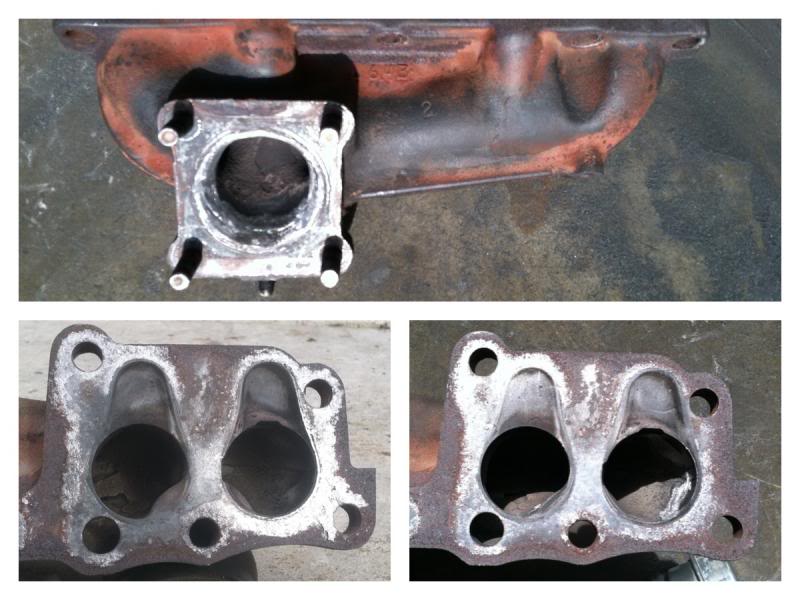

Turbo Manifold: Next up since I had the die grinder out and was working on the manifold I opening up the exhaust on my turbo manifold to 2.5" and smoothed a few of the bumps inside my turbo manifold.
Stock manifold ports on the bottom left and the smoothed out ports on the bottom right. After all that the turbo bolted right up to my manifold!

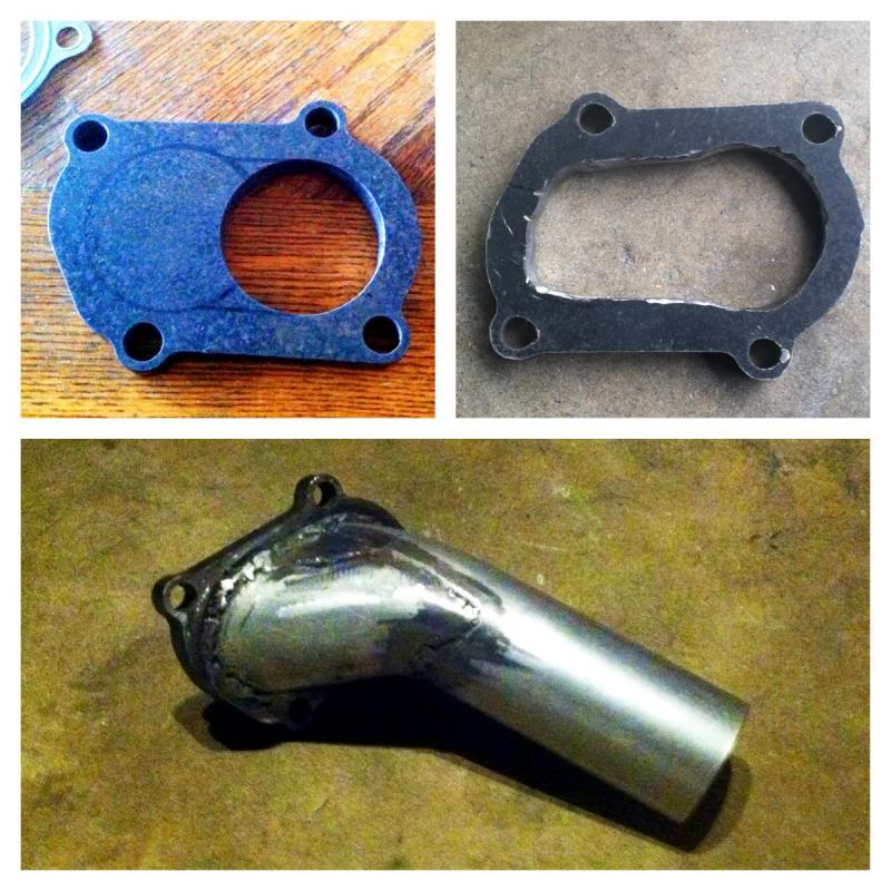

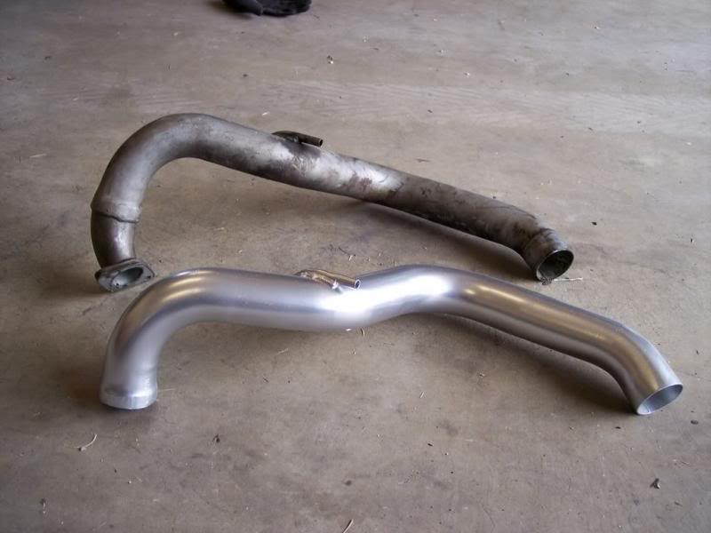

Downpipe: As for a down pipe you can't use a Supra down pipe because the turbo is clocked differently so you have to make your own. Here's the making of my turbo down pipe.

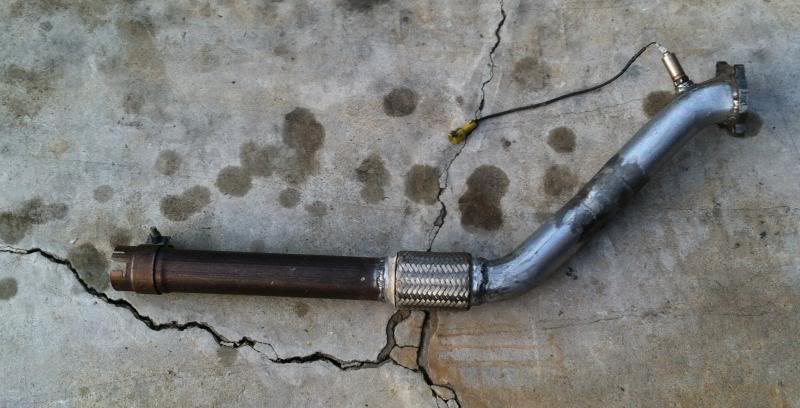

I started with the blank flange, then opened it up to clear my waste gate. To make my down pipe I installed one of my 2.5" mandrel bent tubes where the turbo outlet is on the flange, then welded on a straight tube on the left side of the down pipe to bring it all together. From there I welded on another 45 degree bend to level it all out, then added a flex pipe since I've heard that's part of the reason why our factory turbos crack. Here's a picture of my complete down pipe.

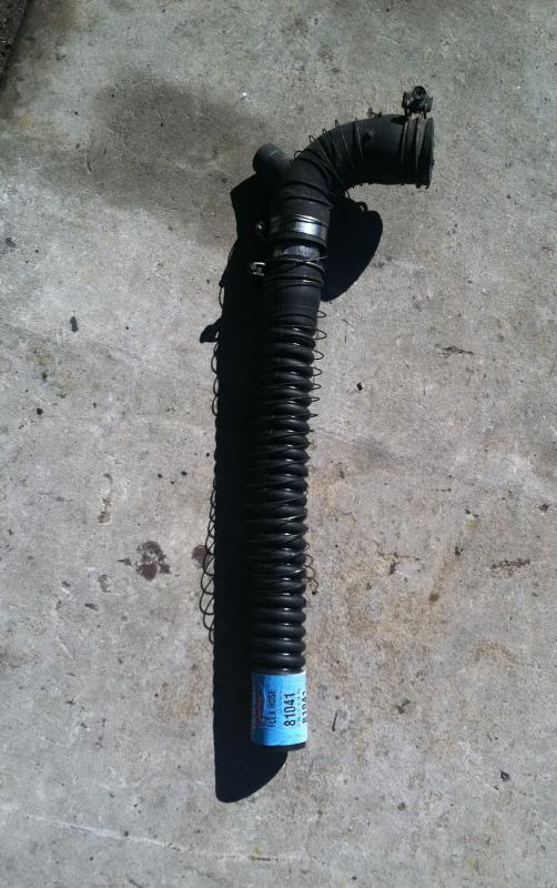

Lower Radiator Hose: One issues I ran into was that the larger turbo didn't clear the metal coolant hose from the water pump to the lower radiator hose. So I cut the rubber elbow that connects to the water pump right after the nipple that connects the heater hose, put a piece of 1.25" steel pipe in there, clamped that in and then added a 1.25" inner diameter flexible rubber hose to the other side so that I can connect it to my radiator. Here's a picture of the setup.

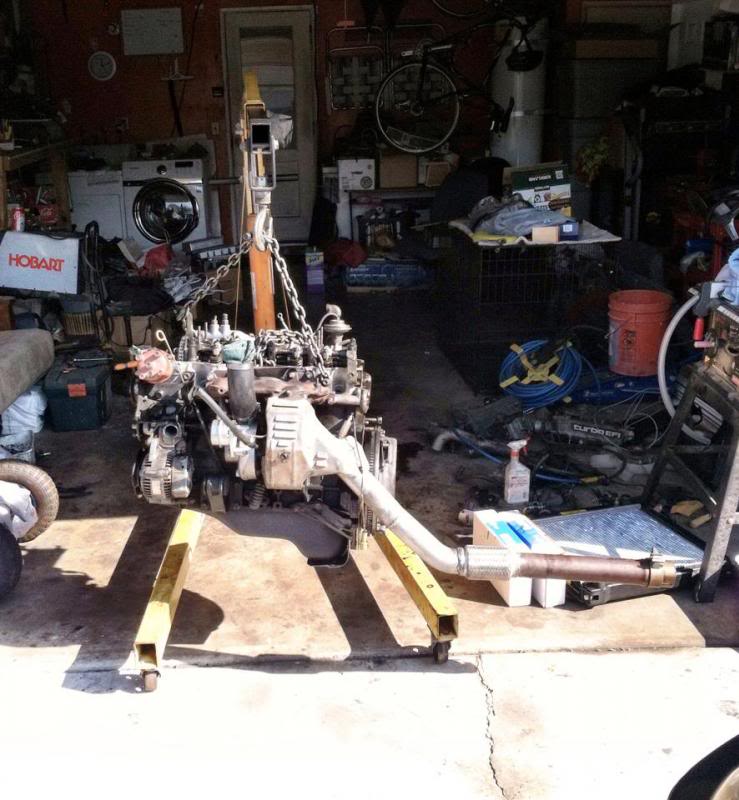

Here's a final shot of everything in place right before I dropped it in!

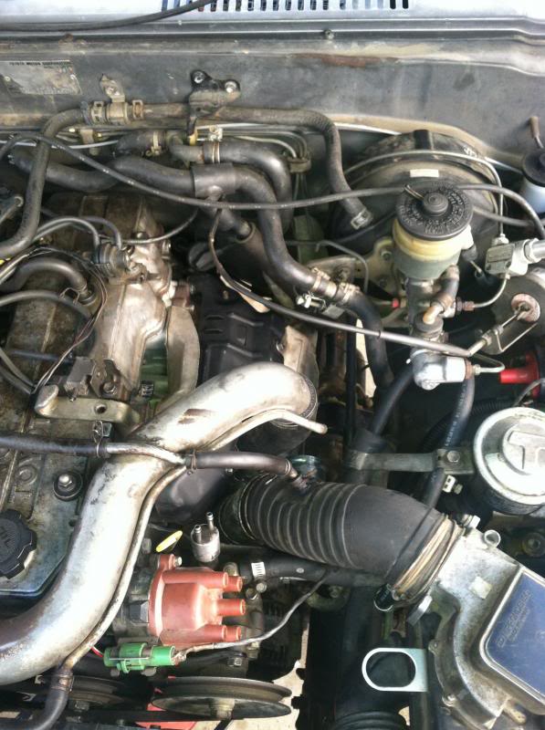

Here it is in the truck.
There are a billion things in this picture so it makes it hard to tell what's going on, but you can see how the 45 degree silicone turbo coupler connected my turbo and charge piping.

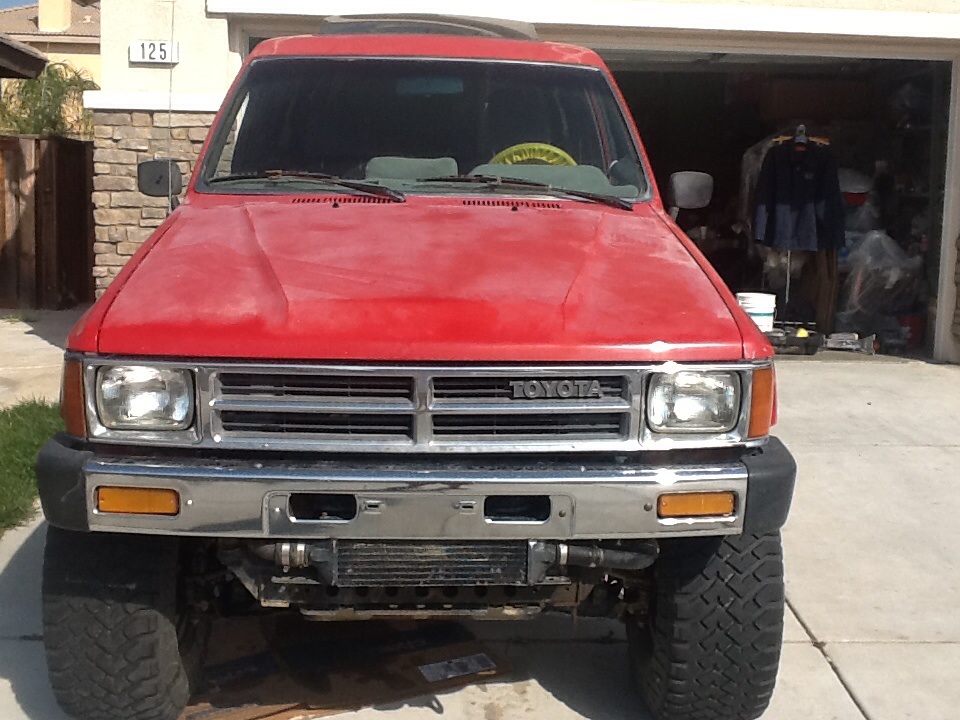

Wink Got ah crack on the turbo :(
Nice write up there. My 87 4runner 22rte has a nice size crack on the exhaste side of the turbo. You can see it from the top with the hood open. Small gap were you can see a nice crack . Thanks for your write up, just what the doctor order. Gonna start grabbing what i need too get this going for mines also.
