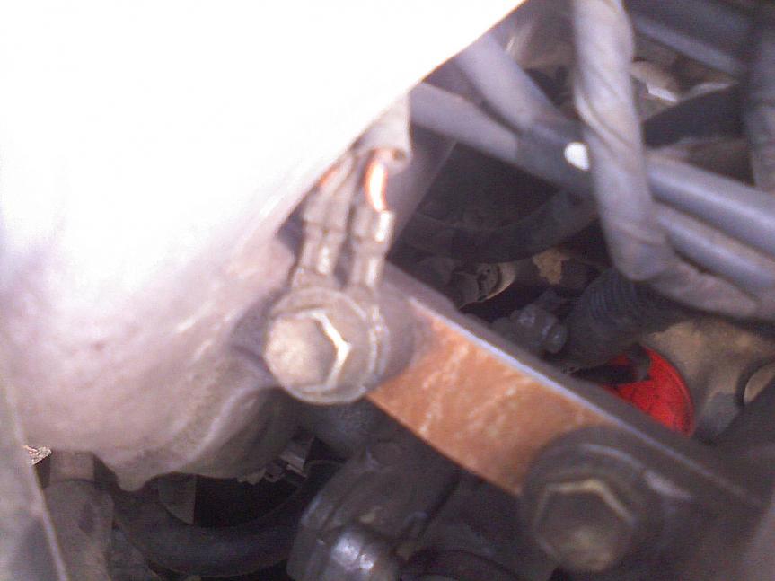

Does the ground look like what I described? I have it attached between the middle intake runners to a stud where the upper and lower intake bolt together. I've looked multiple times to make sure everything is connected and I cant find anything I have doubts about other then the possible ground wire. If I check the injector plug with a volt meter and I have 12 volts but the noid light does nothing what do I need to check/change?

Old Mar 6, 2009 | 07:53 AM
raydouble's Avatar
Joined: Dec 2007
Posts: 500
From: Rochester, Washington
Does it look like this?
Brownish red with a black stripe?
I think it is the injector ground, it's mounted on the bolt next to cylinder 3 where the upper and lower intake plenum are bolted together.

raydouble - That would be it exactly. Now I know I have it in the right spot.
