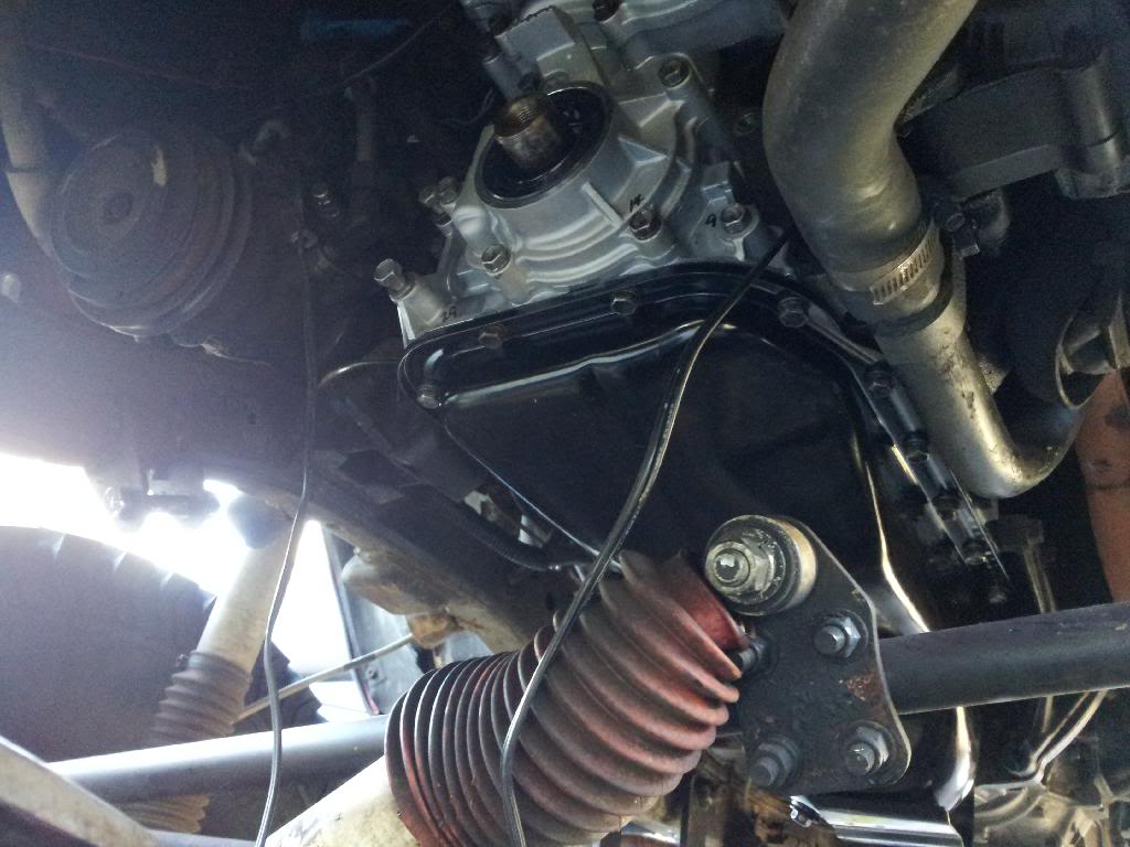

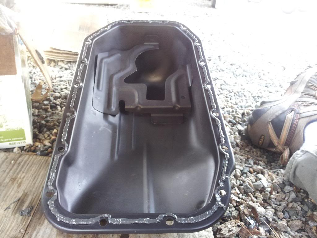

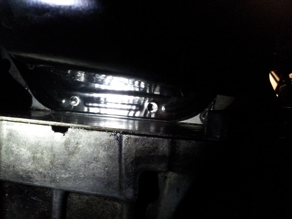

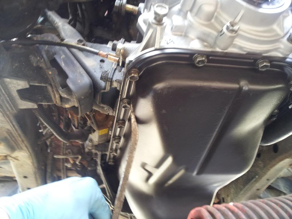

I'm making progress. Here is the TC and oil pan back on
BUT....

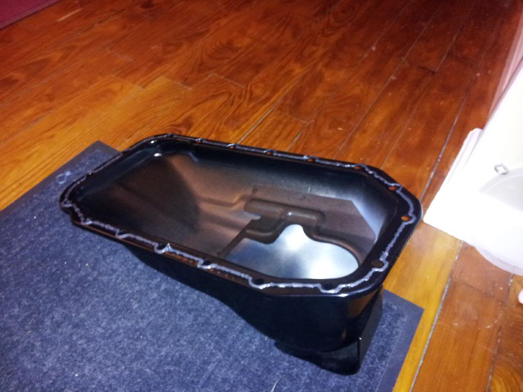

This is NOT how you should FIPG your oil pan - you're supposed to go INSIDE the bolt holes. My 12:30am logic got the best of me, my 8:30am logic slapped myself.
So already I need to drop the oil pan and fix that, at which time I will also fix this: the 2 rear-most bolts did not line up well at all and I had to pry around on it to get things to line up. I don't like prying on formed sheet metal, makes me think of warping which makes me think leaks.
This was a new aftermarket pan, made by Spectra. Perhaps I could have gotten better alignment by installing the bolts in a different order, but given how hard I had to pray it around, while all other bolts were loosened, I don't think so. I'm switching back to the stock pan, see if it installs easier. And I will FIPG it correctly, grrrr.

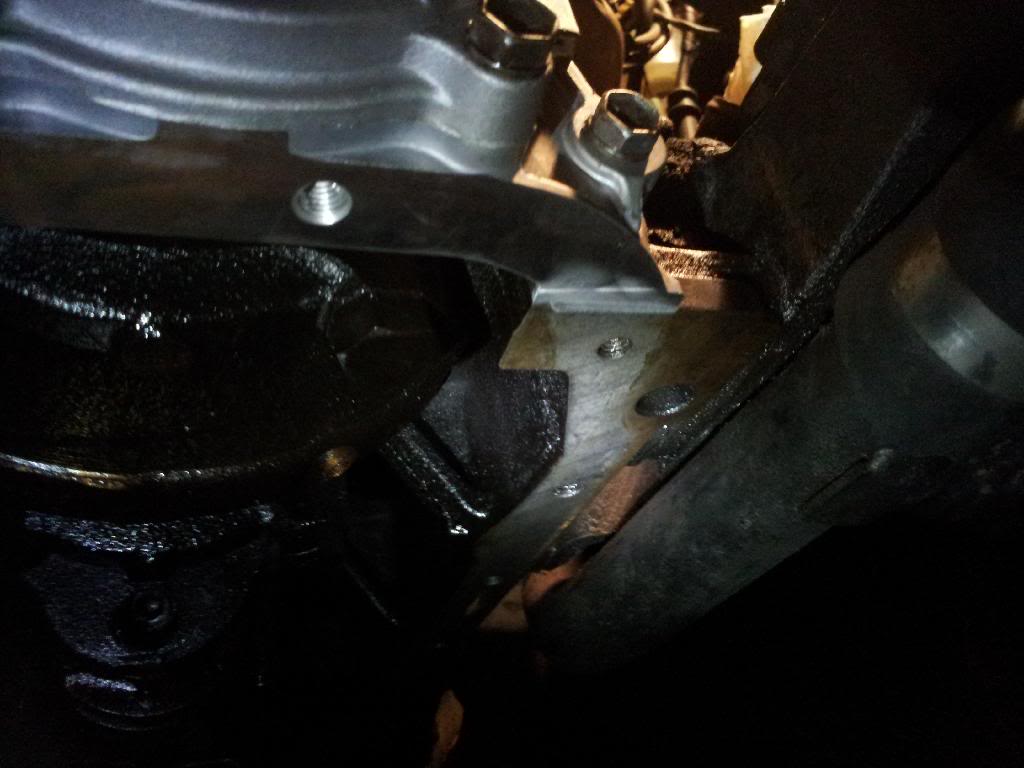

2 gasket hiccups: passenger TC cover gasket needed about 1/16" trimmed off the top, driver needed about the same trimmed off the bottom. DRY FIT YOUR GASKETS BEFORE INSTALL.
Passenger: (it lines up better than this pic makes it seem, but if I hadn't trimmed the very top it would have interfered with the HG)
Driver:

Old oil pan went back on nicely. Still had to pry it over a little for 2 bolts, but not near as bad as the aftermarket. I tried different bolt pattern approach, too, maybe that helped.
Did that, got the AC bracket, power steering, alternator all mounted and put new o-rings on the distributor. I'm down to belts, hoses, and radiator. Can't wait to fire it up, really hoping I got it all right.
Better oil pannery:
Oil pan nudge:
Lots closer:

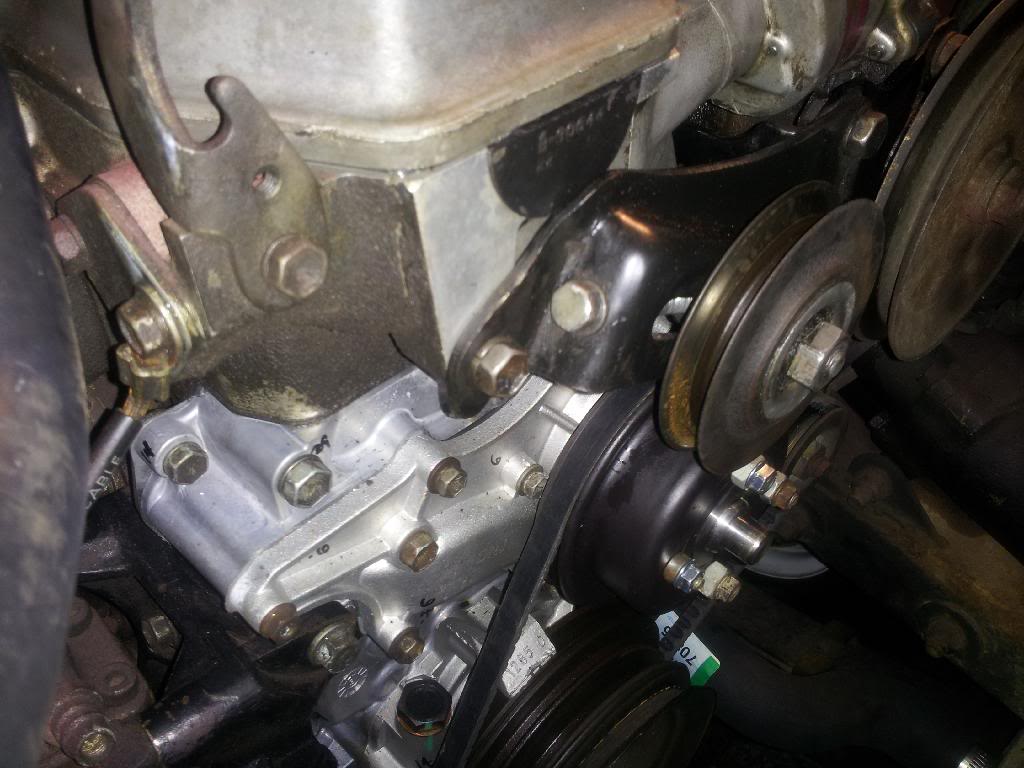

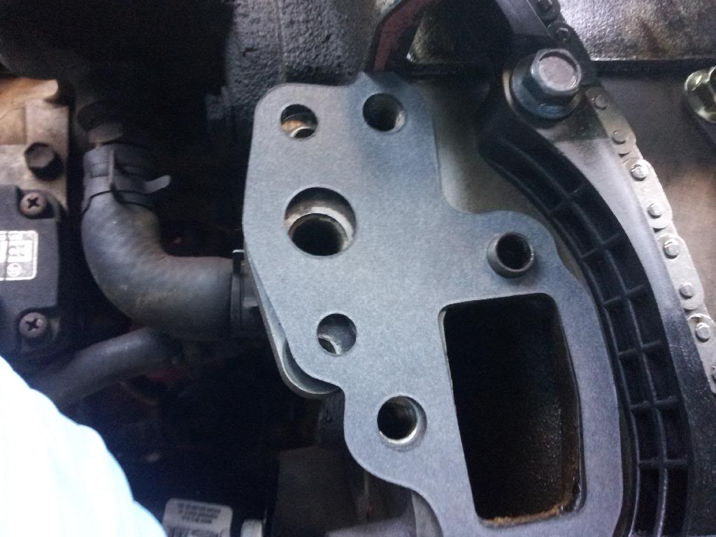

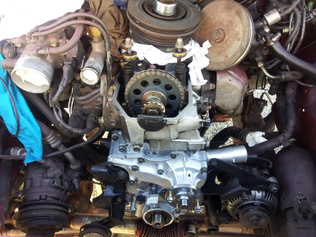

Wow, looking great! Yours is coming together nicely. My future brother-in-law and fellow off-roading enthusiast came over today and we went out to the garage and worked a bit on it. I feel we made some great progress, but while cleaning the block I bumped the headgasket and it now sits about an 1/8" away from the head bent down slightly - shoot! I'm hoping I didn't totally jack it up. I mean, you can take your finger and just push it up against the underneath of the block, but man headgaskets scare me lol.
The issue in question:
D'oh!!
I'm just hoping I didn't put a kink in it or something stupid. I guess we'll see when it is all together and has oil in it! Still...
But apart from that, everything went great! Here is the progress -
Test fitting gaskets (thanks FGZ) -
Test fitting cover -
So I decided to use a little blue thread locker on the guides just for extra insurance. I don't think anything is coming off, but I have a little peace of mind about it.
I'm hoping to soon have the gaskets on and then the cover.
I tested my pulley wear spot and I think I'm fine.
