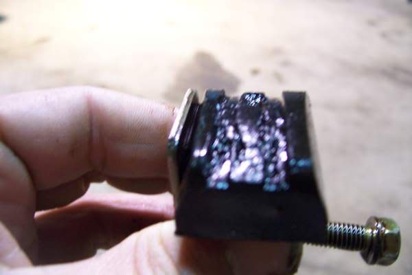

thook's Avatar
Join Date: Sep 2005
Location: NW Ark on wooded ten acres...Ozarks at large!
Posts: 8,656
Received 15 Likes on 13 Posts
Originally Posted by smackay
My mechanic didn't replace the tensioner. I will ask him about the torque issue, and will check maintenance records supplied by the former owner to see if the tensioner was replaced when the original chain was replaced, about 100k miles ago.
Enggg.....a reused tensioner.
This is how one looks after the second time around.
