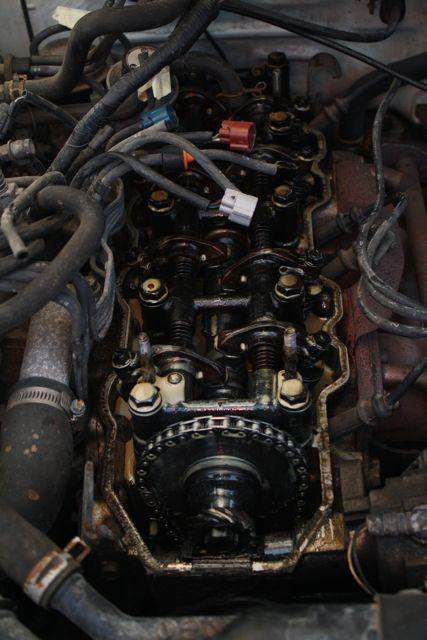

Below are a few pics of what the situation was looking like under the valve cover. Pretty funky. Tracks from the TC rubbing were ~1 mm deep toward the top and maybe 2-3 mm deep toward the bottom.
HawkStrong16, the link you suggested contains VERY similar images... great lead. Thank you.

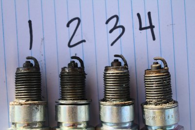

Pulled the spark plugs today. Do you guys think these seem to contain sign of fluids in the combustion chamber?
