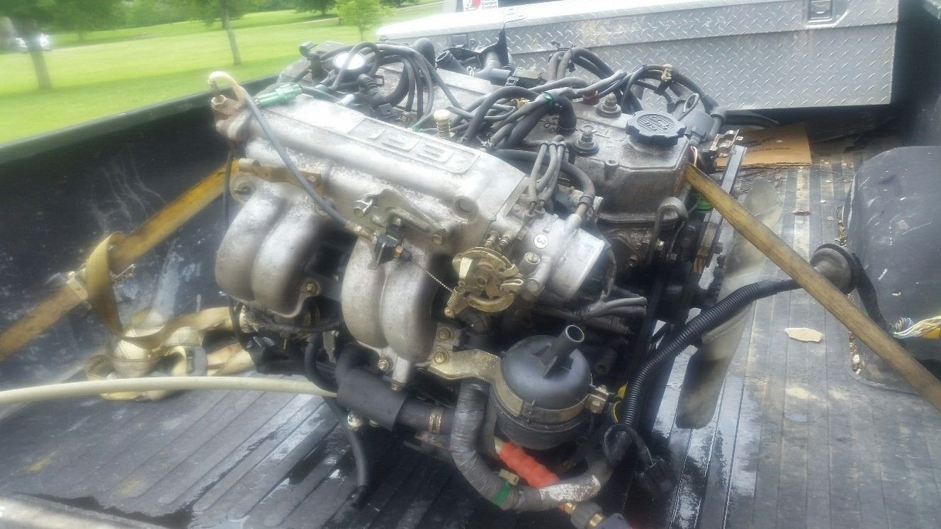

Yesterday I purchased a 1988 22RE engine removed from a destroyed 1988 Motorhome. The Motorhome fiberglass shell was destroyed by a falling tree turning the whole RV into junk. The Motorhome had 70K original miles and was equipped with an automatic transmission. I was able to hear the engine run before removal and it runs great and looks pristine!
I have read about many of the rebuilds of 22RE engines offered by various commercial rebuilder's having the option of installing an "RV" cam which which is claimed to ad 8-10 HP to the engine and leads to my question:
Did Toyota install different camshafts (the "RV" cam) in the 22RE engines that were installed in 1 ton cab/chassis's that were sold to RV manufacturers/converters for their RV conversions?
