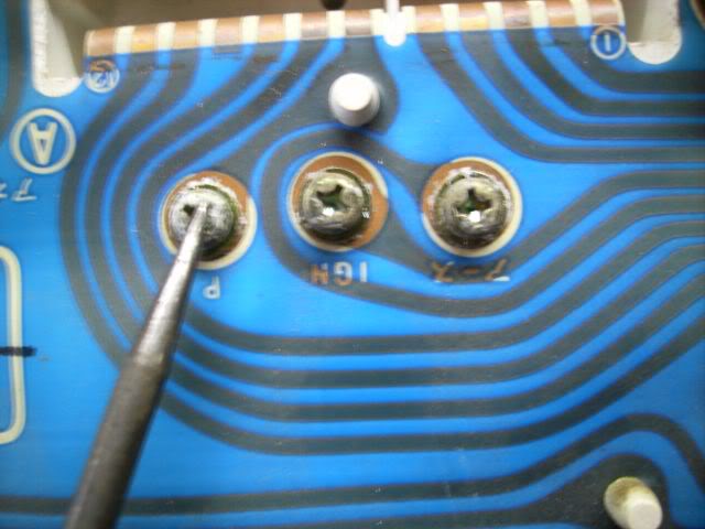

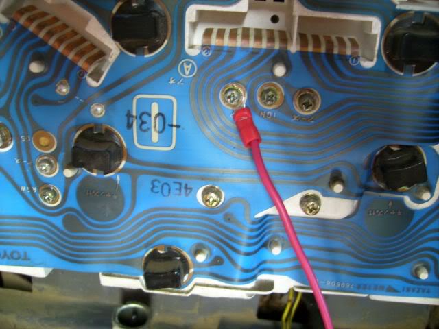

SR5 TACH wiring help... So converted my 88 Pickup 22RE to run on propane with kit from Gotpropane. Install is going good and now just have to finish up some plumbing issues. My question is I have an SR5 gauge cluster in the truck and I am not sure what wire I need to hook into to get the tach to work? I installed a DUI distributor when I did the conversion so I removed the factory coil and distributor. To power my new DUI distributor/coil combo I tied into the hot wire from the old distributor plug (key on 12 volts). There is another wire on that plug that is not hot so I am thinking that will send the signal to the tach but just was curious if anybody knows for sure? The DUI instructions state several places that hooking the tach terminal to anything else will/can mess it up. Any help?

Wire your Tach signal to the back of the cluster or directly to the cluster connector.

Thank you for the pictures very helpful. I was able to figure it out. The one green connector on my truck that hooks up to the coil has a black wire with red line and a black wire with red dots (from harness running from the drivers side). The black wire with red line is hot with key on and cranking. The other wire is the tachometer signal. I put a male end terminal in both and the coil works as does my tach! Attached is a link to a short video I shot explaining it.
