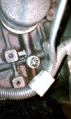

How in the world does this plug not reach now?!!!
Removed the intake mani for a repair. Put everything back together and now this plug mysteriously doesn't reach by about 1 friggin in!!! Made sure there were no obstructions and had the shortest route. It's getting to the point that I'm questioning if it even goes there. But everything was labeled except this guy. And it looks obvious that it goes there. Now my truck won't start and I'm getting a code 12. Wtf? Does anyone know what this plug is for? and would it keep my truck from starting?

the brown one? that goes to the oil pressure switch/sender that sits below the oil filter. your might not be brown. I think mine was black. it's a single wire.

IIRC (it's been ~5 yrs since I had a 22RE) there's also a single wire knock sensor connector near that area, maybe above the oil filter. Is there any possibility those 2 are switched?

Just to the left of the oil filter it looks like a sensor used to be there but not since I've worked on this truck. Would a code 12 keep the truck from starting?

left of the filter is knock under is oil pressure. did u hook up the vac line to the fuel pressure regulator?

Update- the starter wire came out of the plug. But now I have to put my old water pump back in cuz the new one is bad. Doesn't want to spin freely. Nothing seems like it ever wants to go like it should!
