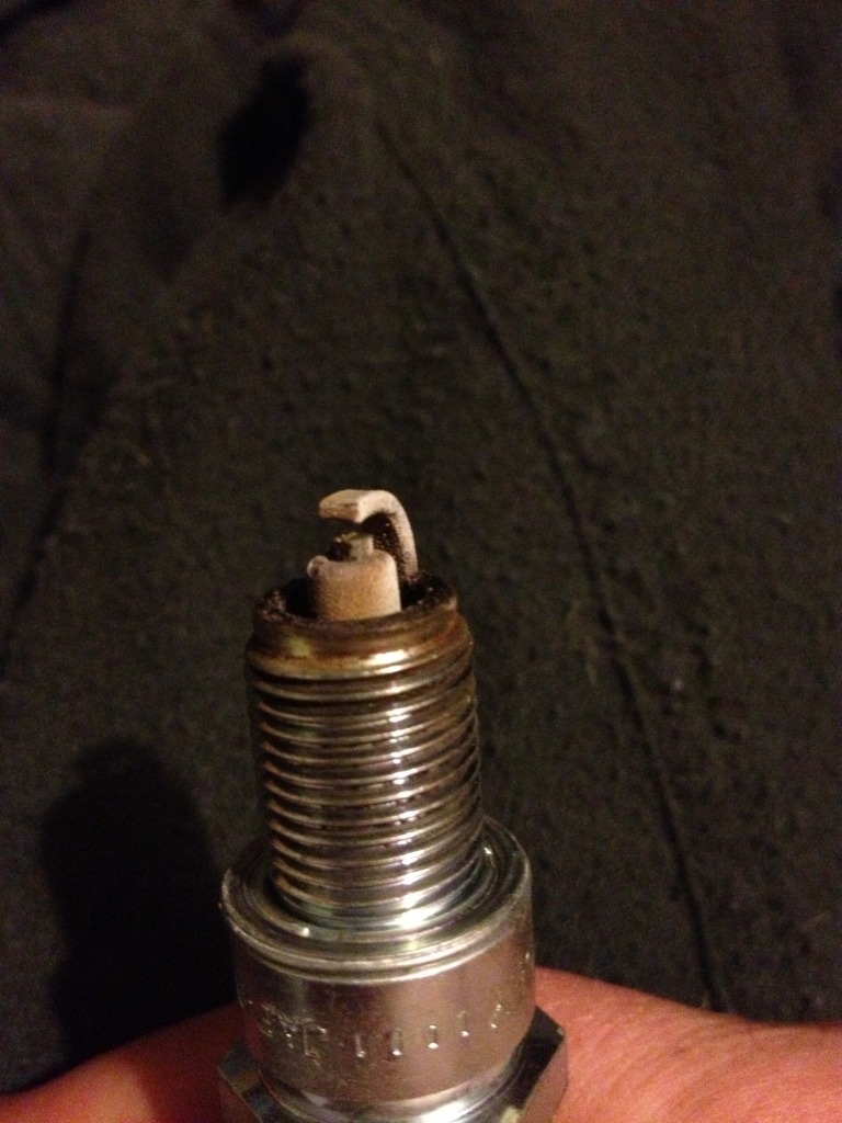

Had a NEW head put on at about 250,000 miles. Ran great for a while but started pinging some time after the install. NEVER did before. Compression test shows ~180 psi in all 4 cylinders. Oil consumption isn't an issue after getting the new head and mechanic said cylinder bores looked good. It does foul the plug in #4 pretty bad since the head job. Other 3 are clean.

What kind of plug fouling? If it's oil fouling, that might be your ping.

Best I could get with my old camera. It's black but not oily.
It's only one plug, it looks black, but not oily, with a bunch of gray stuff plastered to it.
This pic is a little better. It just looks burnt when the other 3 are clean.

Yeah, there's some buildup in that cylinder, somewhere. And possibly others. The other three look like this?
