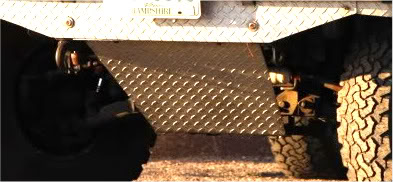

yeah, i can do it. but id rather just drive it. oh well, maybe i can do a write up on it for the kids or something. thanks for the replies man, love your skid plate too!

Ah OK thanksName:  _MG_2611-2.jpg
