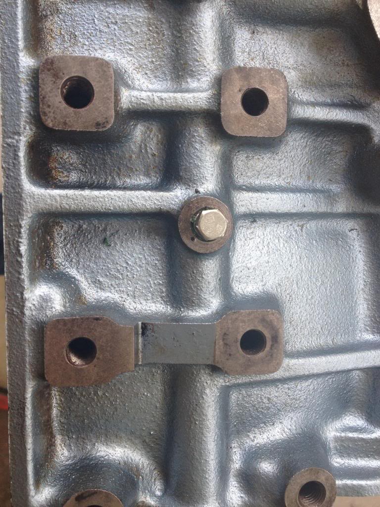

I think these are the main 4.
1. On the left side of the block to the left of the motor mount

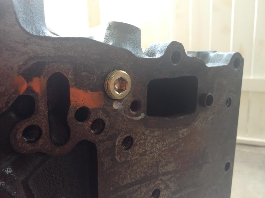

2. Under the block

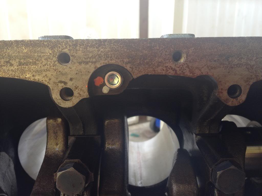

3. Front of the block
