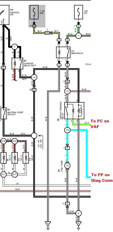

Here's a slice of the EWD (for 1993, but almost certainly the same as yours).
So, yes, from pin 4 to pin 2 you should have continuity (though with some resistance) through the FC coil of the COR. If your relay is working, you should be able to apply 12v from 3 to 6, and separately from 2 to 4, and hear the relay click each time.

Thank you guys for the useful input. I think i am narrowing this issue down day by day. I am pretty limited to how long I work outside on the truck since it is still 110+ in phoenix all the time, but ive been chipping away on it. I just tested the fuel pump with 12v to the connector to the pump (the one right by the fuel tank). The fuel pump starts up and has good flow out of the rubber return line.
also For some reason, I can't jumper Fp to B+ at the diagnostic anymore, and I cant jumper it at the COR connector either (with key on) Could I have a broken wire from the COR to the fuel pump? I think I need to re do the tests at the diagnostic port to make sure I can trust my VAC COR tests.
I applied 12v to the COR pins 3 and 6, and 2 and 4 separately and could hear a click for both of them. Good news. I think my COR is good.
FC to ground in COR connector is continuous. No voltage fc to ground on VAF connector side. No continuity to ground for e1 (vaf connector side also)
At this point my guess is a broken wire from the COR to the fuel pump (can't jumper fuel pump from COR connector points to this) , and also a broken wire from the VAF to the COR (no voltage for fc and no continuity for e1 point to this) ? Seems unlikely these 2 wires would break at the same time.

I am still trying to track my issue down. Right now I have the intake manifold off and fuse box taken apart to further inspect the wiring. I only had 2.2 volts to ground at the B+ diagnostic terminal with the key on. Why could this be so low? and why not zero volts could this be a bad connection along the wire that provides power? I read somewhere that If b+ is not getting enough voltage, then it will either cause the engine to run bad / die / or not start. When I jumper the fuel pump from the battery positive terminal directly (instead of b+), I get good amount of fuel and pressure coming up the intake manifold. I am sure the COR relay is good, however I only get 2.2 volts to ground at the COR socket. Battery is good and has 12 volts.
I am a little stuck on how to trace the positive battery wire. I know that it is the white wire with red stripe. If I had 0 volts at b+ and cor socket, then I would know it is broken, but what does 2.2 volts tell me when it should be 12??

With modern multimeters with very high input resistance, it's very hard to read zero volts on an open wire! When any wire with a tiny current is "next" to an open wire, it can induce just enough current in the open wire that you'll read a voltage. If you put a relatively high resistance (~1-100k ohms) to ground, that "ghost" voltage will go away. Modern industrial voltmeters have a setting that does just that. https://www.fluke.com/en-us/learn/bl...al-multimeters
So I'm sure your 2.2v just means you have an open wire in the battery voltage side. Based on your report, I suspect that your EFI relay is closing (you hear the click) but the contacts aren't making a connection. Can you measure voltage to ground at the EFI relay at the B-G and R-W wires? If you get battery voltage on B-G but 2.2v on R-W (key-on) that points to the relay. Then a positive test would be to pull that relay out of the socket, and then just jumper those two leads (simulating a closed relay). If your problem clears up, chuck that relay in the can.
