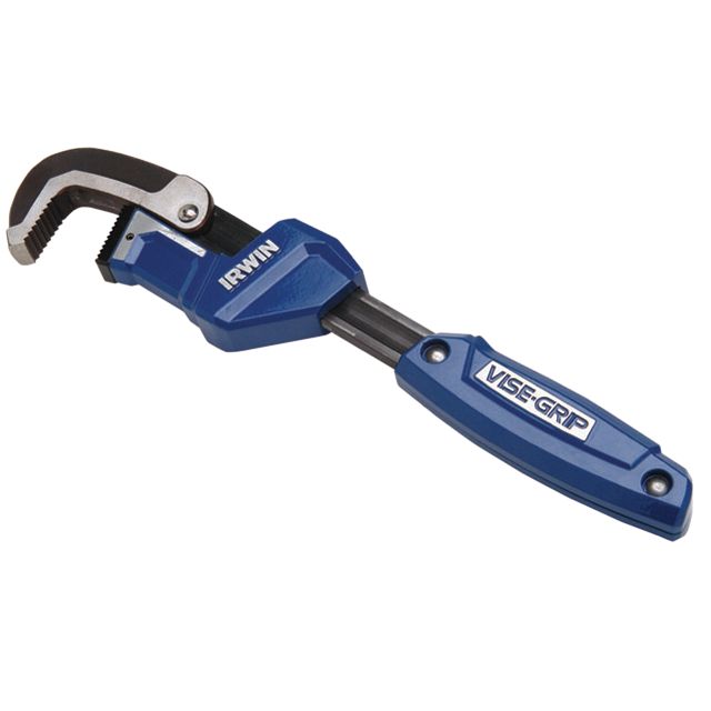

If a bolt does snap and you dig into the head gasket job, what I used to get mine out was a Vise-Grip pipe wrench just like this one:
I was able to get a bite on the studs, despite one only having maybe 1/2" left above the block's surface.

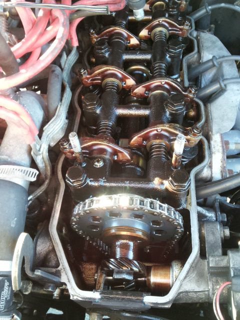

Now that I got my Datsun running again (replaced a leaking heater hose that ran from the engine bay into the heater core - sense a theme here?...), I had the guts to try out Bleeder's approach to re-torquing the head bolts today.....
Loosened a quarter turn in the same order as the FSM says to tighten, then tightened to 58 ft/lbs in the same order, then again to 63 ft/lbs. No snapped head bolts, yay!

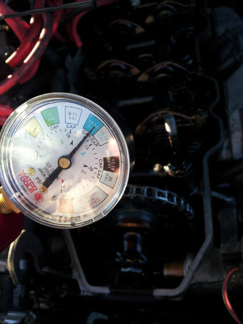

Did a pressure test on the cooling system and it held 13-14 PSI for 20 minutes with no visible leaks. Then idled it for 20 minutes and no visible leaks.
