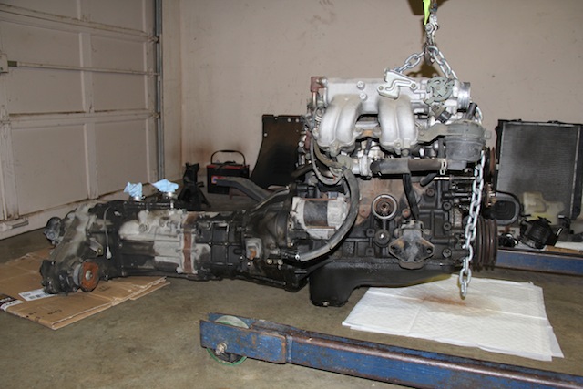

Hey brianh699, thanks for the reply.
That makes sense, they should be the same.
Started the process of pulling the engine today. Will need to buy a second engine stand, cheep at Harbor Freight.
Hoping to have the engine out tomorrow to begin the swap.
Ill post all the differences with pics here so the next person might get some benefit from it.

Engine swap complete and running! My first rebuild!!!!
Here are the differences I found. Not a lot of differences.
Ill post the pics with the 89 first followed by the 93.

Hope this helps the next person wanting to swap similar motors....
