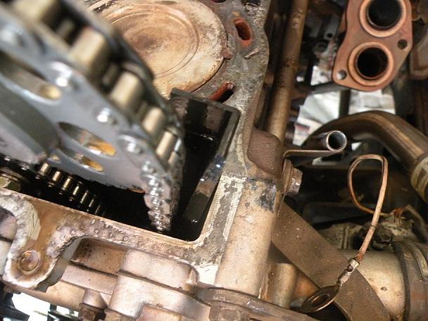

So went back to garage to give a few more tugs and got it off. however I broke the top bracket thing on the right plastic chain guide.
Do you think it will be fine like that or should I replace it?

Can't really tell from your pic and I hate to tell you to pull the t cover, but if you have any q's about it's condition and you're already in this far...
It does look like your guide is a little chewed up there though, so give it strong consideration. If you get new guides a lot of places sell the steel backed drivers side including engnbldr and most folks report good results. The only place that I know of that sells steel backed for both sides is these guys:

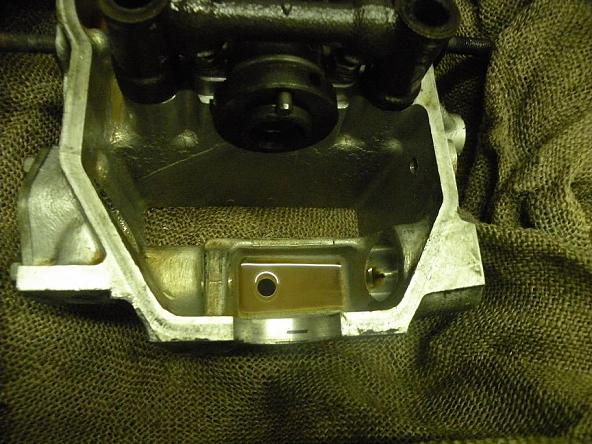

A question I have for you. What's going on here?
Is that a broken off bolt? And was it that way when you tore down or did you break it? If it was already there it could have contributed to your failure.

No it isn't. It was just oil haha. The camera made it look like it was solid didn't it?

Also I didn't have the bolt in front of the rocker arm assembly as shown in the pic

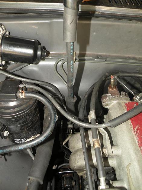

So I have pretty much everything back together, but I never took a picture of this one hose and I can't find any place for it to go !!!!!!!!
Can anyone please please help. Describing it would be great or if someone has a pic of it??? that would be even better!!
Its between the charcoal canister and egr valve

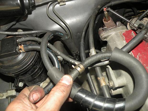

It looks like it goes to the underside of your fuel pressure regulator. My pics kinda suck but hopefully they give you the idea.
The pressure reg from above
The hose you have attached to hardline on the firewall
The other end of the hose. You can barely see the clamp.

You nailed it!!!!!!! Thanks for the pics!!
