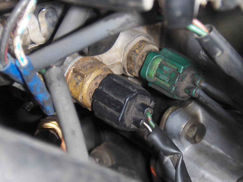

Does it smell like raw fuel out the exhaust? Mine does that once in a while. Stinks like raw fuel. Try starting with throttle open, release when it catches. Probably your cold start injector/time switch is having issues. Easy fixes if so.

I'm thinkin your cold start injector is being told to open when it doesn't need to, putting your engine into a "flooded" condition. You could be losing pressure or "vapor locking" in your fuel rail, but any fuel pressure loss will be recovered as soon as the fuel pump starts. So not as likely, to me. You're probably looking at removing your engine temp sensor and cleaning it, same for the time switch. Usually, they work ok with a cleaning. I've never looked up their cost. Google around for the best info, there's tons of tech on it. I'll get ya started..https://www.yotatech.com/forums/show...180&styleid=53
