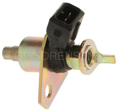

Sounds like you're talking about the cold start injector. Does it look similar to this? Here's a picture of what it looks like and a link of where it goes.
http://personal.utulsa.edu/~nathan-b...88coldstar.pdf
There's a thread where they are talking about this part.

that's it! i just took pictures. i don't have time to post them up right now but i might anyway. so i'm like 99% sure now my cold start injector is leaking. doesn't look too hard to fix though.
so correct me if i'm wrong, the cold start injector basically injects fuel from the fuel delivery rail into the intake manifold when the engine is cold? thus the reason why it idles higher when it's dead cold after just starting up in the morning? i like to learn
