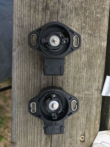

So I have a code 41 which is a TPS. It will not set so I bought a new one from Toyota Parts Deal using my vin. Check out the pics, one is the TPS I took off and the "new" one is one that will not work because the throttle will not turn it because if you look at the position of the device that turns the TPS they don't hit the throttle if that makes sense.

Originally Posted by mrcocoa
So I have a code 41 which is a TPS. It will not set so I bought a new one from Toyota Parts Deal using my vin. Check out the pics, one is the TPS I took off and the "new" one is one that will not work because the throttle will not turn it because if you look at the position oFunny f the device that turns the TPS they don't hit the throttle if that makes sense.
Funny, had the same thing happen when i changed out mine. Brought it back to napa and compared it to another "new" one. No comparison, one was correct the other was just junk.
This has been covered before, lots.
What you see is a first gen and second generation tps. Wrong part in the box or wrong part number. Lots of reasons this could have happened. Shouldn't have any problems getting a RMA.
