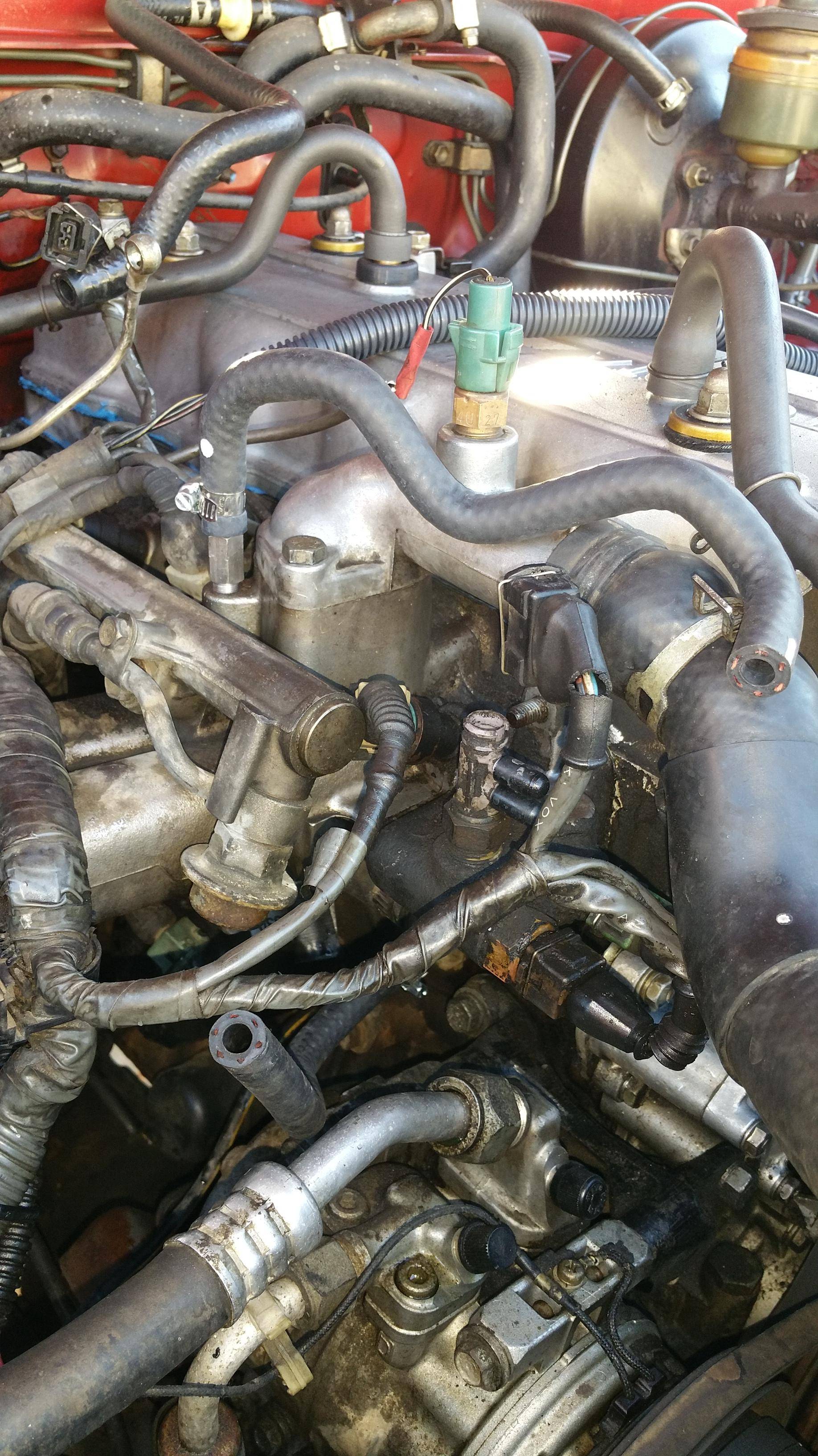

Before

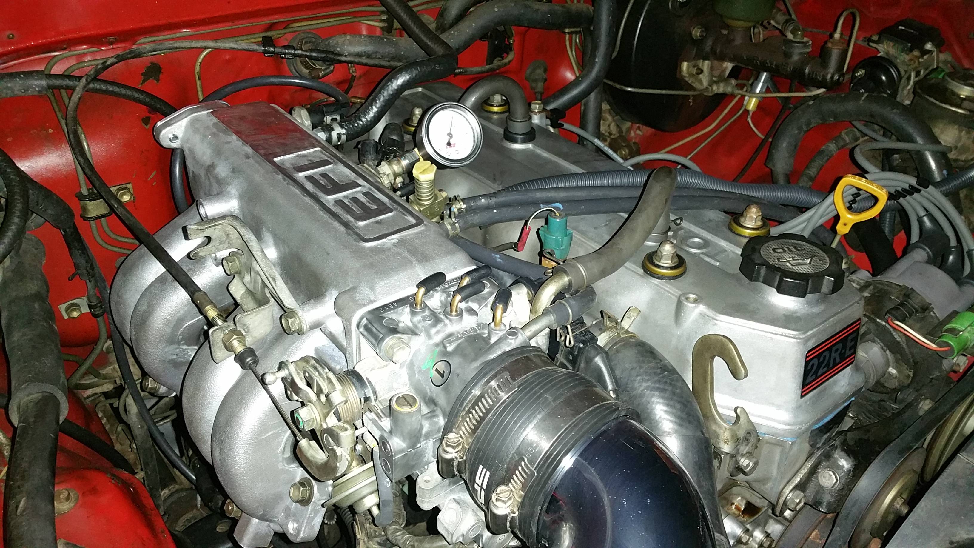

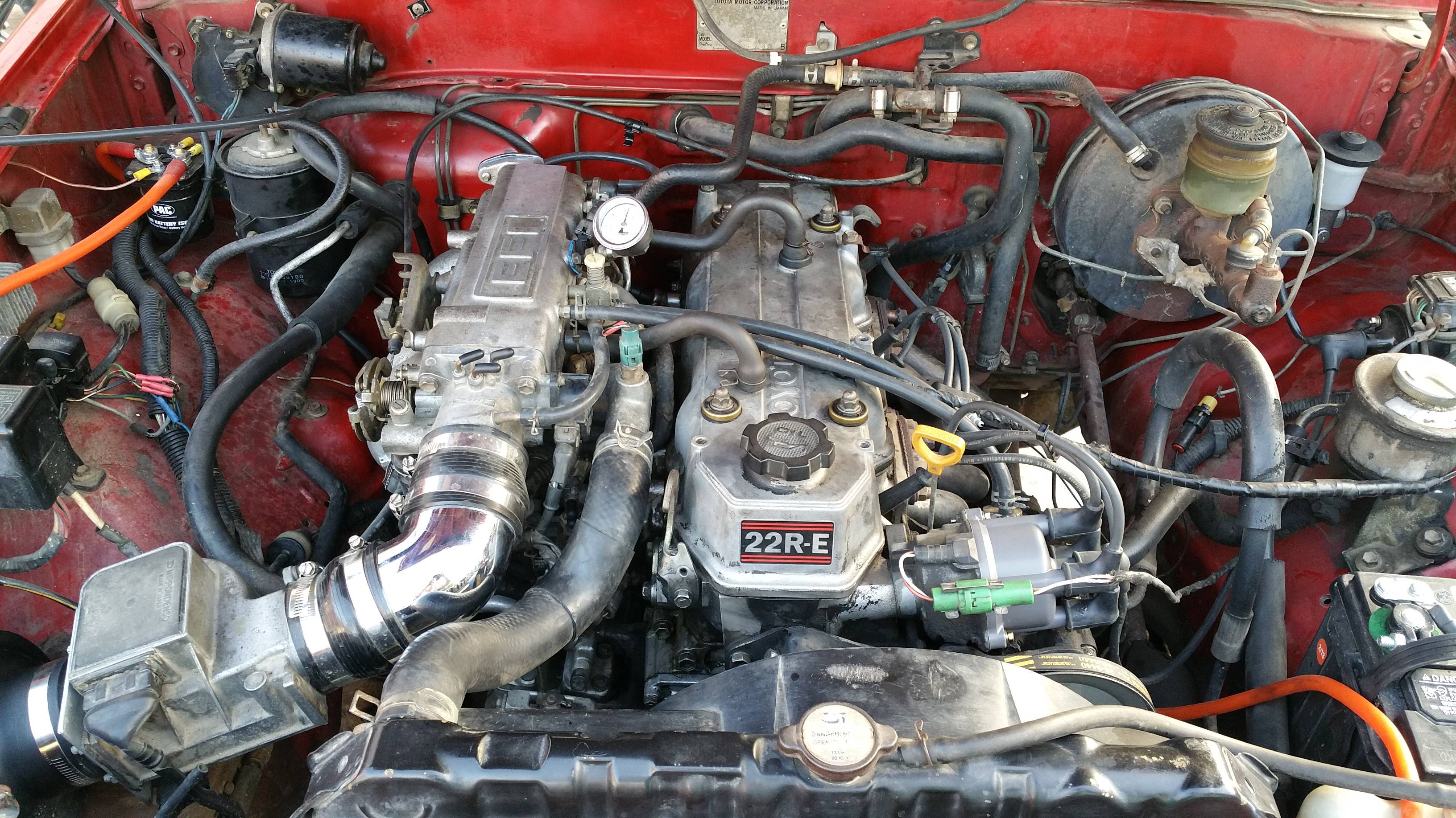

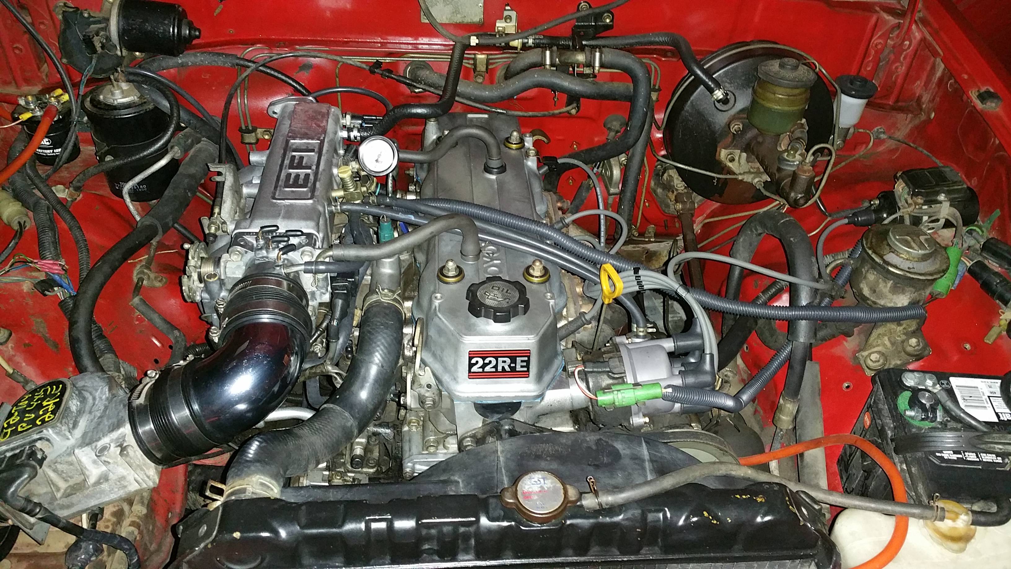

After

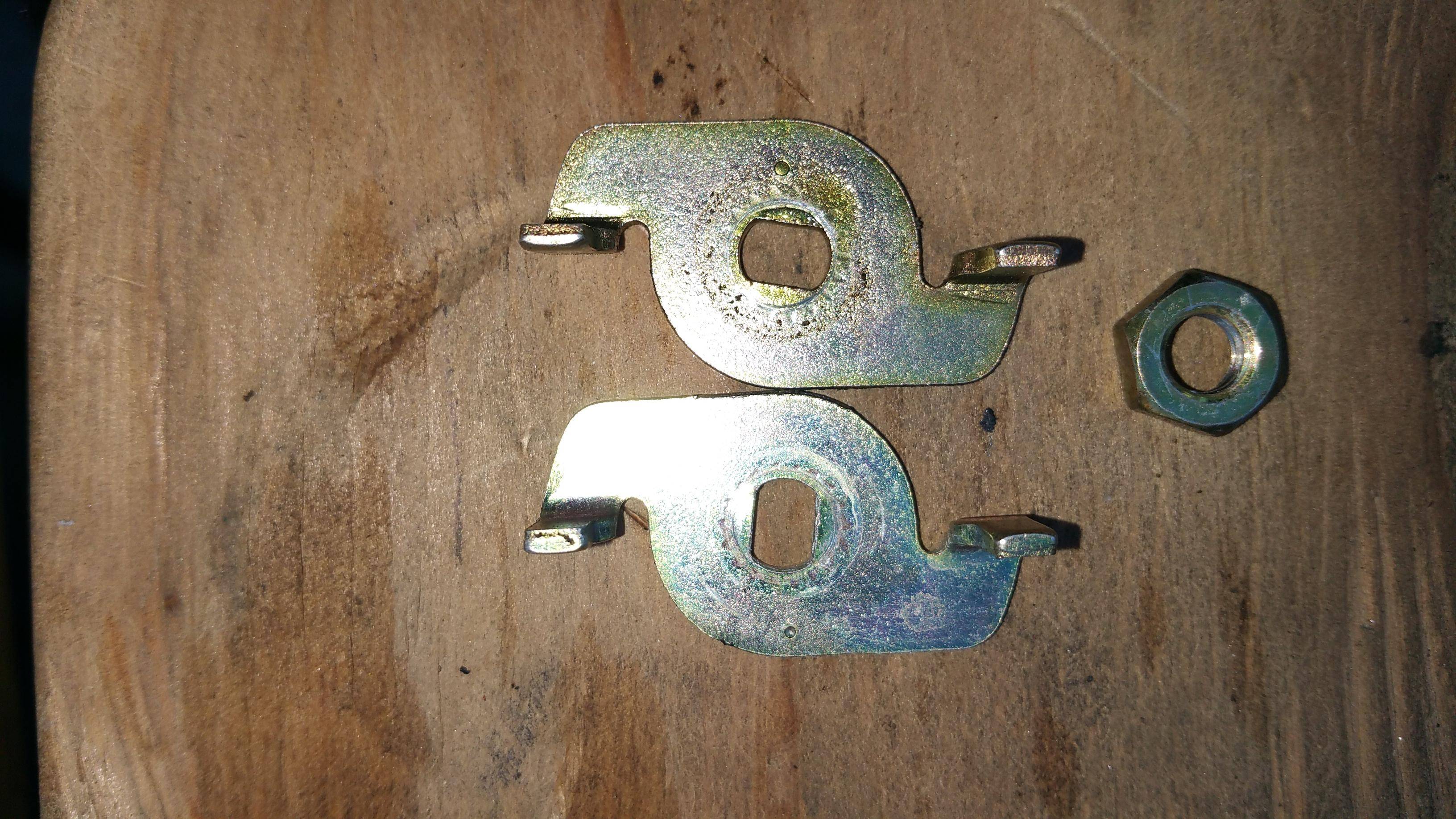

Piece you need to swap from the TB so you can still use your old TPS:
