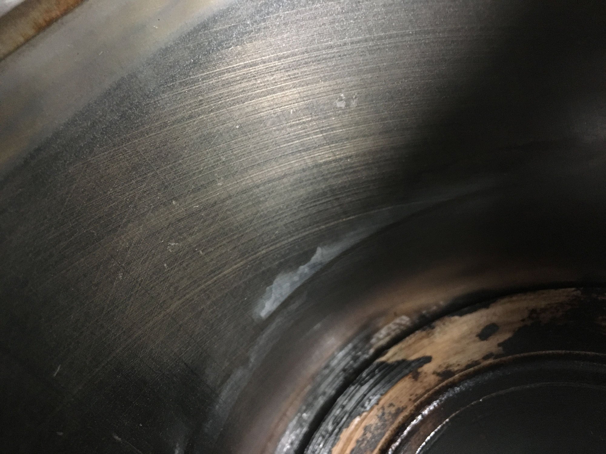

The cylinders look OK to me, there is discolouration where the rings sat for the winter (my assumption). This truck has 260K km's or 162k miles. I am wondering if anyone knows whether that crosshatching could be original?

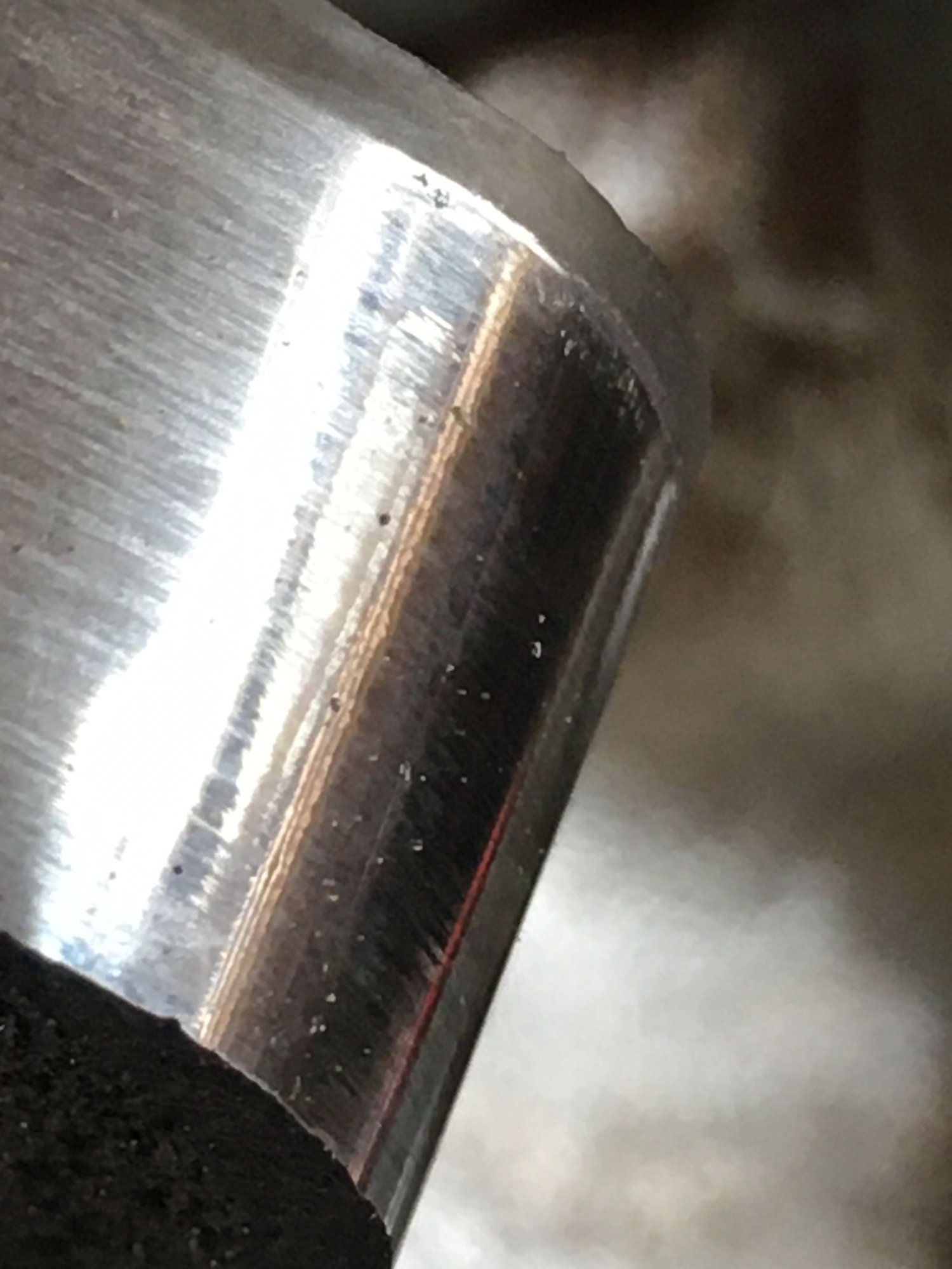

The head looks fine to me, the valve seals are shot, crumbled to pieces when I removed the valves. The cam bearings look great, but the rear cam journal is scored.

Assumed blown head gasket? You could have done some checking about that. Compression test, leakdown test, etc. cam bearings fine but scored journal? How could that happen? Since it's a fun project, might as well go all the way and cover all angles. I don't understand the rationale behind the multiple oil changes routine. Just my $0.02.

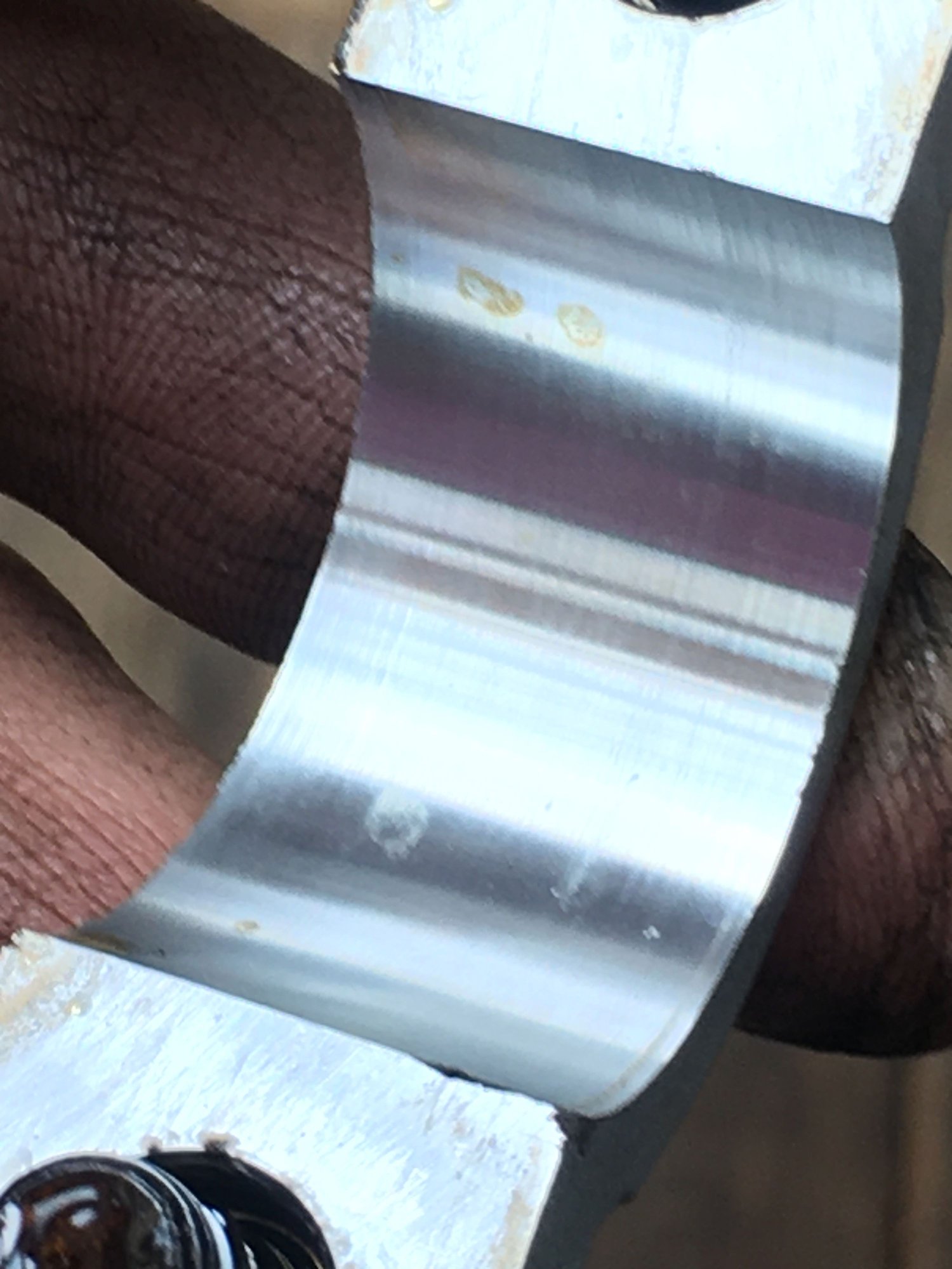

Multiple oil changes was to hopefully get the coolant out of the bearings. I understand it is not good for them. Maybe its only hard on them when the engine is running? Yes, the scored cam journal is strange. I didn't bother to investigate the extant of the engine damage as I was buying it regardless, the price was 1250$ which I am pretty confident is a good deal. The truck came with many years of receipts, it was meticulously maintained. I'll update here once I get the oil pan and timing cover off. I am not afraid to pull the engine and rebuild it, but it seems silly to do so if it is in good condition. Maybe I should check the rod bearings once I get the pan off?

Just did a freshening up on my 22RE last year because of a head gasket leak with coolant in oil.Engine had 174,000 miles on it and still showed factory hone marks in the cylinders just like yours. I was surprised at how bad the rod bearings looked in mine.

So what happened is the timing chain had worn though the timing cover, allowing coolant from behind the water pump to enter the oil. The radiator had no leak. The machinist touched up the head but it was not warped. All re-assembled, new gaskets and seals, new timing cover, Aisin water pump, OSK (Japanese) timing chain, new fuel pump and filter, plugs etc. I also installed new rod bearings while I had the oil pan off. Running beautifully! Quiet and strong! (For a 22re in front of an automatic transmission )I've been driving it the last week and really enjoying it.
