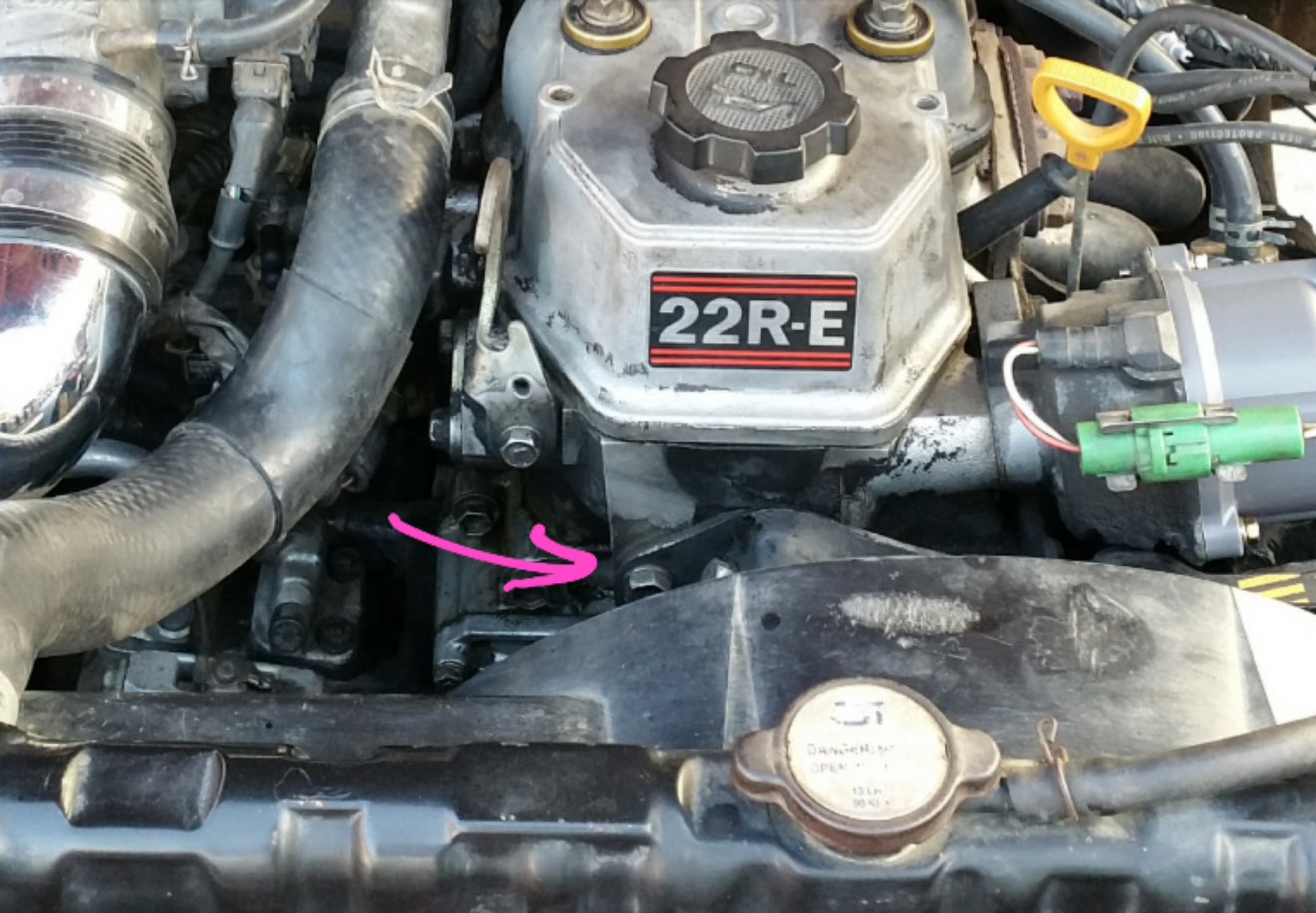

Is this a leaking 22re head gasket?
Disappearing coolant... Mysterious oil leaks, cruddy intermittent low idle startups...
Is this a head gasket leak or something else? Compression is currently 170 / 171 / 177 / 170, no oil in coolant, oil looks normal, plugs are clean
Thank you in advance for any input!
Pic is AFTER wiping a huge oil puddle off there. It appears every time I run the engine for more than 10min

Mine puddles oil there also. I believe it's a leak between the head and timing cover. Although that is the head gasket that is supposed to seal that, it's not the important part of the head gasket. If i had all the symptoms you describe, the only one I would really worry about is the disappearing coolant, I would def try and find that.
Where's that part? How about zooming our so we know neighboring parts?
I'm looking at possible leak around my oil pump myself.

Top of the timing cover, just behind radiator fan
Hope that helps

maybe those half moon valve cover gaskets/plugs. they are notoriously hard to seal right.

there is also an o-ring on stalk of distributor, that could cause leak in that area.
Oh, I see.
Yes, after my engine rebuild I saw seepage there, too. Took it back to the shop and was fixed. I'm hoping that's just the case with Jennygirl's.
I suggest cleaning up that area and monitoring to better see where it's coming from.
Nothing leaking from below? i.e., main seal leak and and pulley flinging oil around? Found that on mine, too. Shop will fix on Thanksgiving week.

Those half moons like to leak. I have started putting sealant in between the half moon and the head. Also if someone forgets to put sealant on the head gasket in the corners, that will cause leaks.
It is more of a problem on the back half moon, but one of the lips can get curled up when installing it and causing a leak. Might try lifting the valve cover and seeing that the half moon is installed correctly on the inside and outside of the head. I have made that mistake before.

This past time I did RTV all the way around the whole dang thing. On both sides of the gasket and all the way around both half moons. I didn't use so much so it would squish into the crank case.
The pool is still forming there. It has to be a gasket or bolt somewhere else. There is absolutely no way oil is getting through all that RTV!
I'll check the distributor o ring thing msane mentioned

if timing chain cover is new and it was not decked with block could lead to leaks in least bad scenario.

the only bolt on front of timing cover that calls for sealant is the top oil pump bolt. center bolt in water pump goes through to block, two top bolts of timing cover go through to block as well. none of the others have access to oil.
I have re-sealed those half moons and still had problems. I ordered just those seals from autozone, and got a nice pair of fel-pro ones. Usually I wouldn't recommend (store or gasket), but they were a chunky thick pair, and worked nicely. I had trouble with that o-ring too on distributor. I order that o ring, and the one that go in dizzy cap every time I start a new 20/22r(e) project now.
If PCV is clogged or not working properly, it will cause alot of oil/air pressure on top end and help with these pesky type leaks as well.
