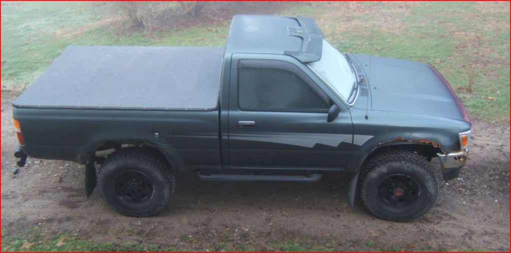

i took some pics today ( i wiill mess with trying to post them late)in my garage...just changed the oil and put those tires you see back on. had it driving around for about 20 minutes (it's not going to be street legal / inspected until Tuesday so I an't REALLY drive it on the street). runs fine, added the sea foam to the oil and gas as I was instructed..............wahooooooo!!!!!

92 TOY's Avatar
YotaTech Milestone-Two Millionth Post
Joined: Jan 2009
Posts: 12,009
Likes: 122
From: Northeast Pennsylvania
see if this works
<a href="http://s670.photobucket.com/albums/v...rrent=0033.jpg" target="_blank"><img src="http://i670.photobucket.com/albums/vv64/92TOY/0033.jpg" border="0" alt="Photobucket"></a>
