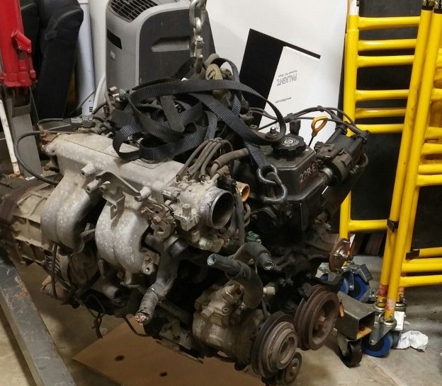

Ive been back and forth with a guy selling a 22RE from the same year truck, unknown miles, said it runs but was leaking oil at the rear that he bough the truck for the transmission, he wants $150 cash. I think I may go buy it Saturday AM and rebuild it myself then just swap them, that way I could still at least move the truck even though the rod is knocking and Id have my engine to either rebuild as take 2 or sell on as a core. I think for $150 its worth the risk that its not roached beyond rebuild!

I'd be all over that deal, where I live clapped out rebuilders go for $300 to 400 all day long on craigslist. You could turn around and sell the EFI intake on ebay for $200 or more so I say go for it.
