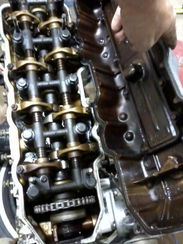

Does the efi cam have a lobe to drive the fuel pump?
Old 12-25-2013, 12:19 PM
Staff
Terrys87's Avatar
Join Date: Aug 2008
Location: Anderson Missouri
Posts: 11,788
Received 21 Likes on 19 Posts
It is the same cam, the 22r requires a oblong dish that drives the pump. You can see it attached to the cam in the following pic, just infront of the chain.
ifi cam will not have the ecentric in place (installed) you would have to remove it from the 22r cam and bolt it to the 22re cam. it is a seperate piece.
