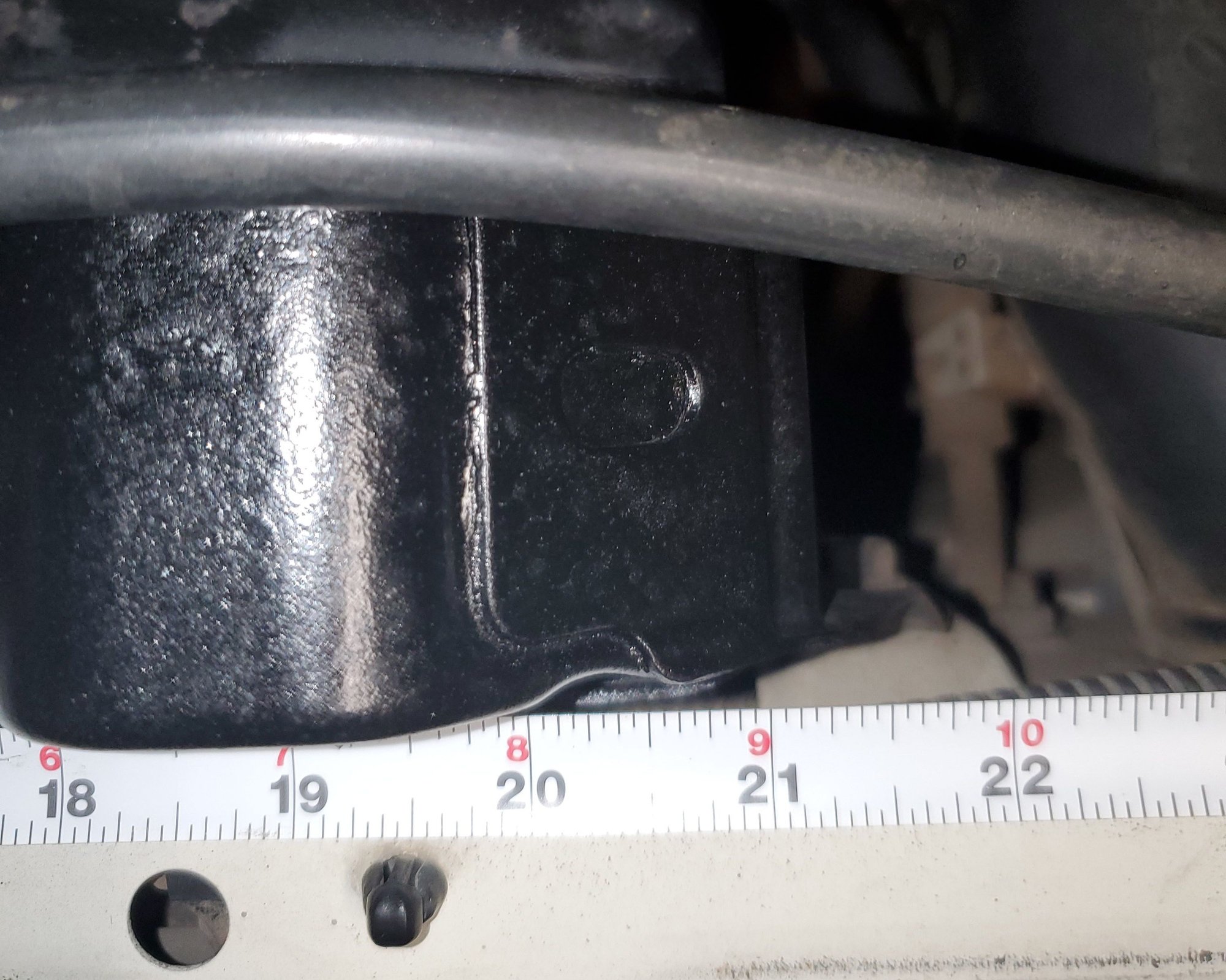

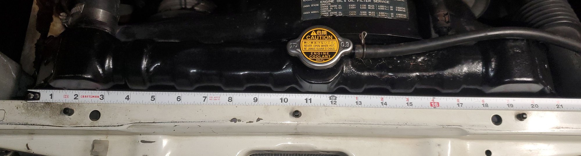

Old Dec 29, 2020 | 09:43 PM

My OEM 22R-TE radiator measures
17 3/4" tall by 21" wide
Old Dec 30, 2020 | 09:13 AM
22marv's Avatar
Joined: Feb 2019
Posts: 15
From: The Mountains
Thank you for that. Is that 17 3/4 tall core or overall rad?
Old Dec 30, 2020 | 11:46 AM
87-4runner's Avatar
Joined: Mar 2012
Posts: 1,139
Likes: 414
From: Oklahoma
The core
