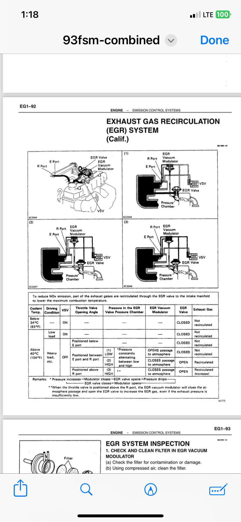

@coryc85 thanks for the rundown, I was actually replying to melrose up there about the water temp sensor. Cold idle is nice and high, I don’t have a tachometer but it seems to warm up with a higher idle and then drops to about 850 as it should. I did look for the bmsv and guess what? It’s not there. FSM shows California EGR systems are laid out with a different vacuum switching valve which I tested (good) and then performed vacuum test on the egr valve itself. Once the engine warmed up it died again. Egr modulator seems bad per FSM test and EGR valve is definitely due for a cleaning so that’s what I’ll try next. Considering an egr delete mod since I’m not registered in CA anyway but really just looking for the most economical option. I’d prefer to keep the egr system intact but not if it’s going to cost $500+

youre right, dropping the fuel tank is a huge hassle if it’s not the problem but at this point I don’t know where else to turn. I think I’ve ruled out the egr system as I removed the egr valve and cleaned it and also replaced the egr modulator. My truck is a california vehicle so instead of vsv on the intake it has an electronic vsv on top of the head. The pages from the manual I shared above illustrate the difference. I tested it and it’s working. I guess I could replace all the wiring and all vacuum lines but fuel pump seems like it might be causing the problem since it could be that the electric motor on it is dying and functions worse as it warms up.

Ok I misunderstood when you said missing the valve, I thought it was actually missing, but you mean it never came from factory with one because of california emissions, now I understand.
