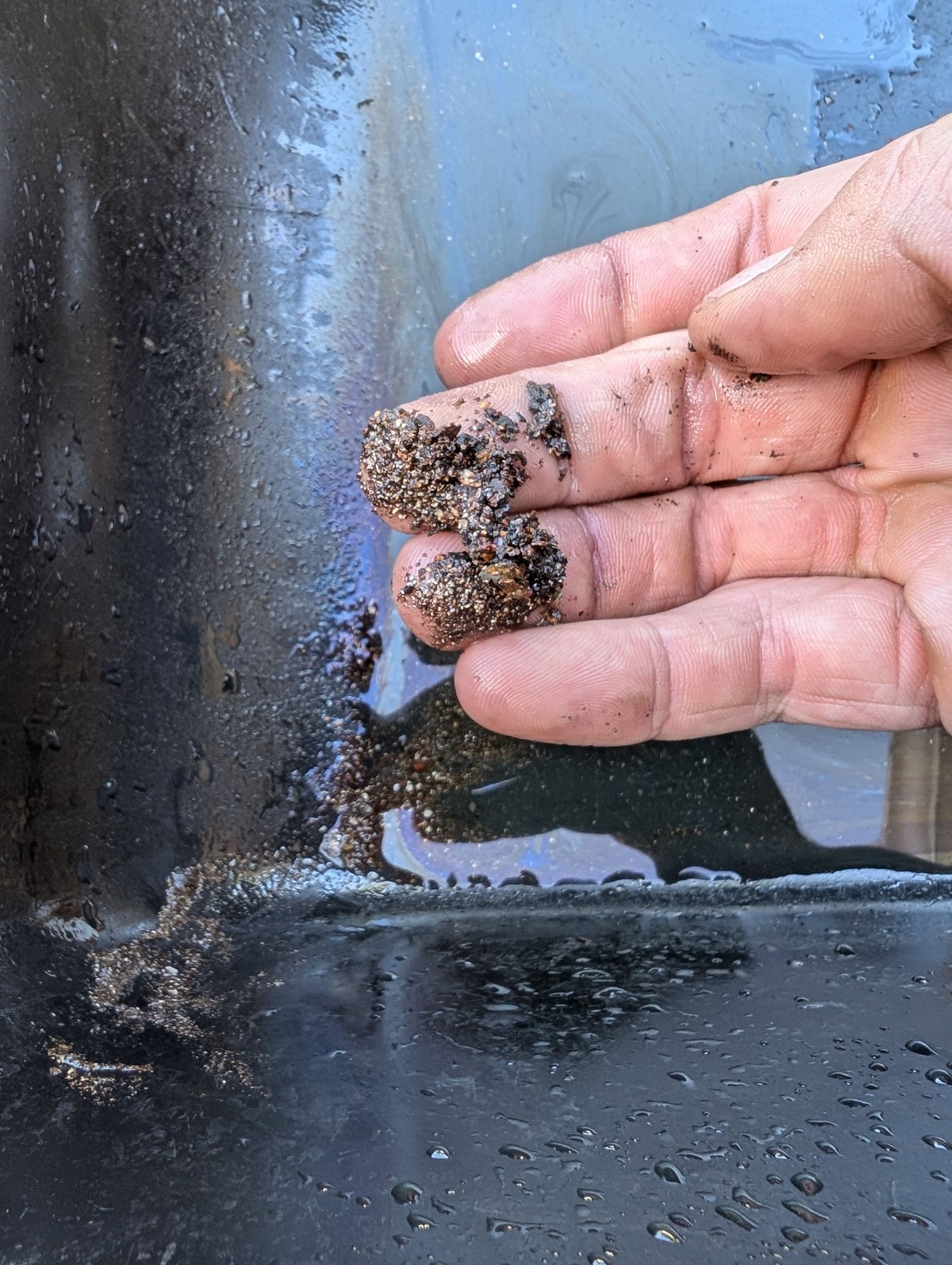

A couple of things have happen since my last post.
I took my wife on a date in the truck.
I passed Oregon DEQ with flying colors.
I installed an OEM drivers side mirror.
I replaced my Chinese headlights with more Chinese headlights.
I removed a bung in the block and flushed a significant amount of crud out of the block.
I drove 60 miles at 70mph WITHOUT OVERHEATING.
All in that order.
This is huge but may be a red herring.
Aside from stoking my wife out, buying really expensive stickers, having a mirror what stays adjusted, and having headlights that work I MAY have fixed the problem we're discussing today.
The truck had previously steamed out and overheated in under 20 miles.
Ill now start using the truck for day trips with hopes to gain the confidence to drive more than 60 miles from the house.
Ill do my best to keep this thread up to date.
The photo is NOT MY WIFE. Ha. Its my dog Eddy on said 60 mile drive.
Trash
Not gold panning
After headlights amd before mirror
