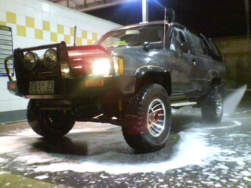

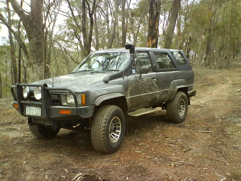

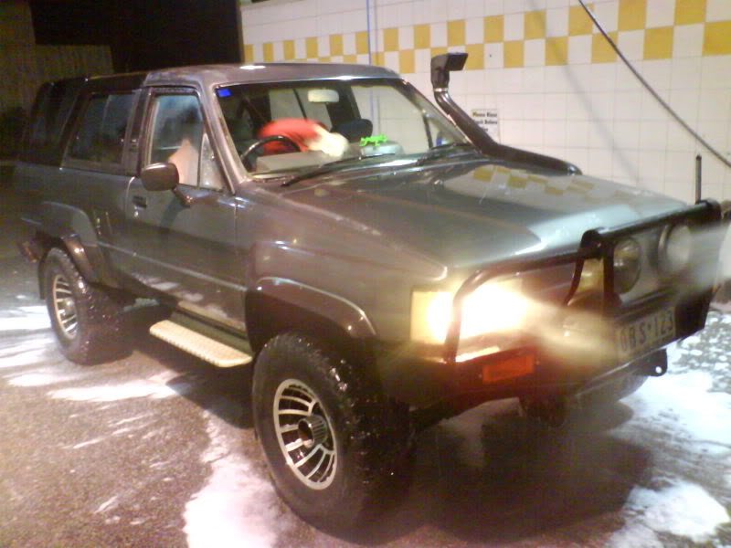

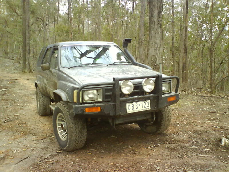

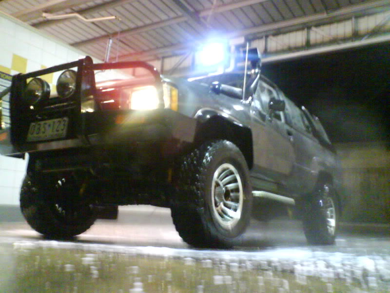

here are some picks of my 4 runner on the morning befor it broke down, i will take som picks of the engine bay and post them soon

nice looking 4runner

Alright - now I'm extra jealous. Sweet Runner!
