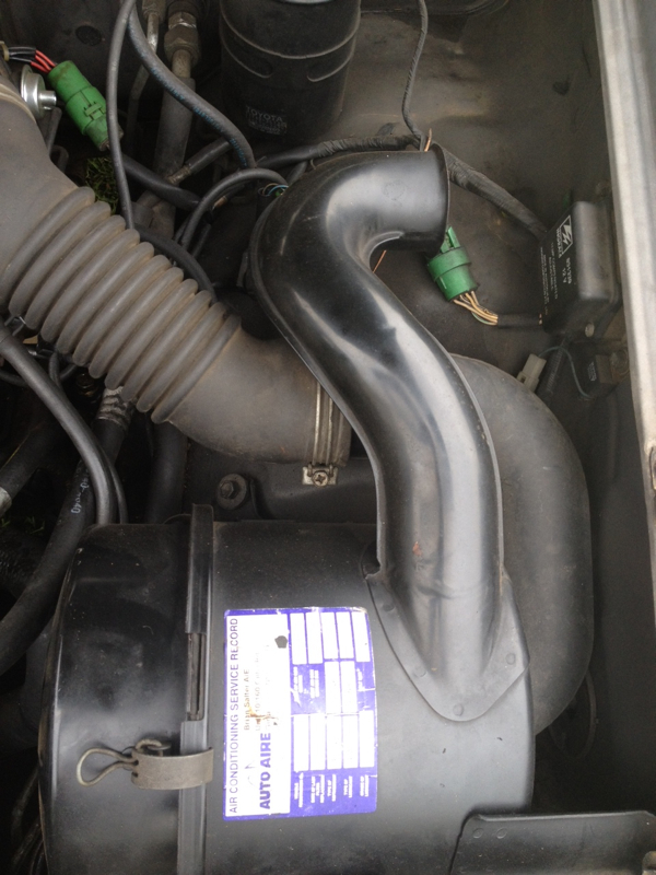

This is the airbox.

Thanks fellas. I've bought a snorkel. I'll make it fit. Am I right to assume it fits to the end of the air box? The little pipe off to the right. Then time to paint the truck!

yes you are correct, its designed to fit the stock box, i just did one on my buddys 3rd gen. the instructions should explain everything. if you are mechanically inclined you shouldnt have a problem. its always scarry cutting into your rig.
