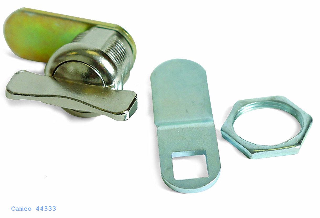

NEEDS A LATCH MECHANISM
It will latch on to lip of body panel. I don't need it to be locking, yet. I a want minimal, low-bulk, low-cost solution. Would appreciate your inputs.
Nice work RAD
Is this the bsic idea on the latch?
https://www.ebay.com/itm/Craftsman-T...QAAOSwx5RanL9C

Originally Posted by L5wolvesf
Nice work RAD
Is this the bsic idea on the latch?...
.Craftsman-Tool-Box-Lock-Chest-Key-Storage-Truck-Safe-Cylinder-Chrome
Yes
But debating whether to use keyed or one with heftier twist handle. Although I could simply leave the key on the lock/latch
​​​​​Then, I'll set ut up so when I want to leave it open longer, like when I'm working on something, Ill hang it from my "tie-up" points right above.

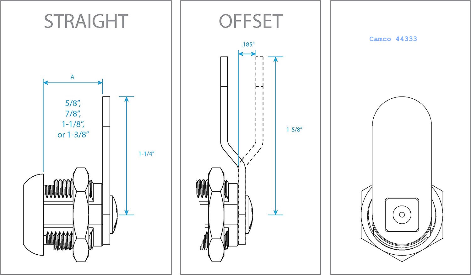

I was trying to figure out what it would be called without a lock and came up with
https://www.amazon.com/Thumb-Latch-C.../dp/B007JGWVDM
Yes, similar but simpler....
Camco Cam Cabinet Latch
