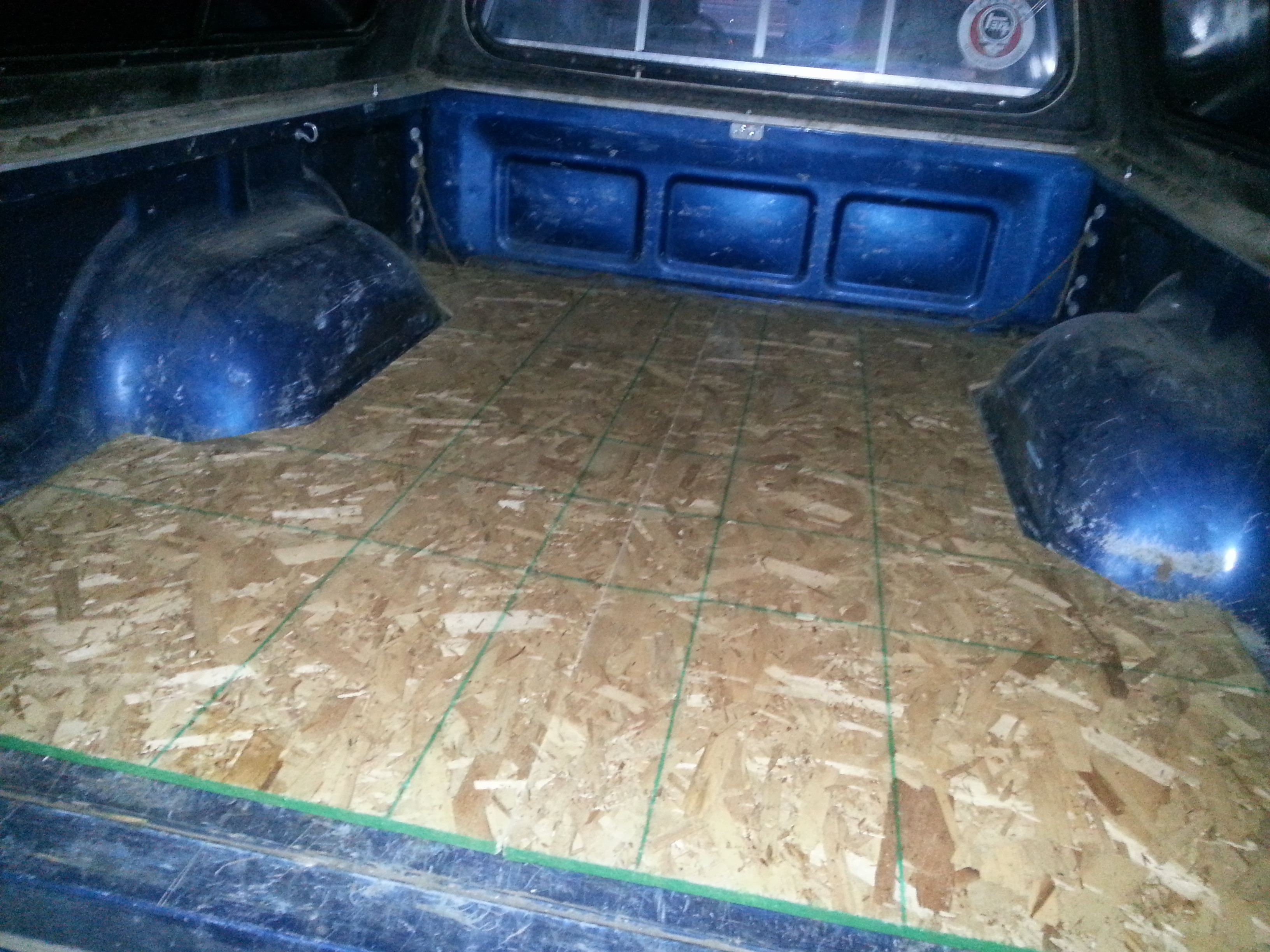

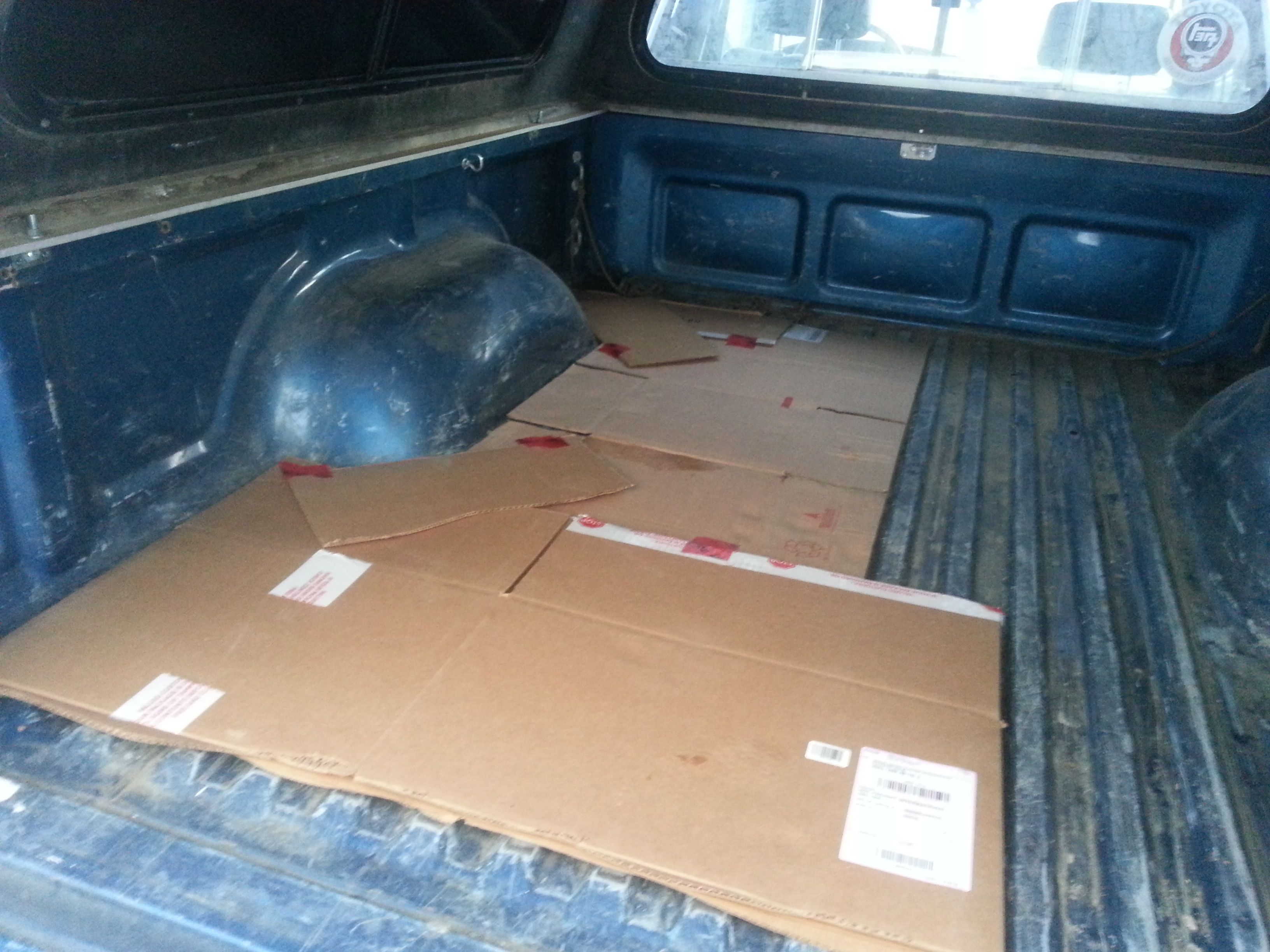

The easiest ay to get an accurate fit, especially if there are many rounded corners, is to make a template with cardboard. Just did this yesterday..
