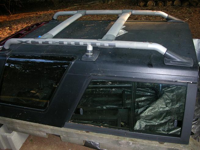

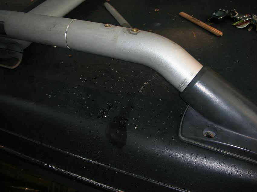

Cut and reassembled rack
Left work a little early today and decided to tackle the rack mods. It was a total of three cuts per main rail. I have a cut-off saw so it was quick work. The rails are reassembled with a PVC pipe insert that I will later epoxy once all of the foot mounts are located and drilled. This left me with only one butted mating point that is barely noticeable and will be filled in and painted along with the rest of the rack to a dark grey that will match my sideview mirrors. (you can see it in the close-up of front foot) I'm really liking the way it looks and can't wait to see the top back on the truck with it.

That looks good, and its a perfect fit.

I'd screw with people and leave the Xterra sticker on it, slower people will think it's an "early one" ir "1st gen" X. But I enjoy messin with people and would lie and tell them they're right. Does look like you got it to fit nicely though.

Wow, that looks great!
I was looking at my '06 4Runner roof rack and was like....hmmmmmmm...
