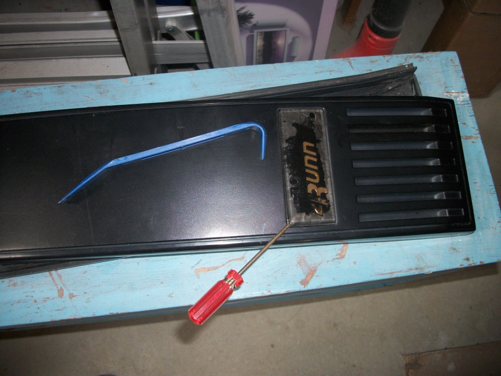

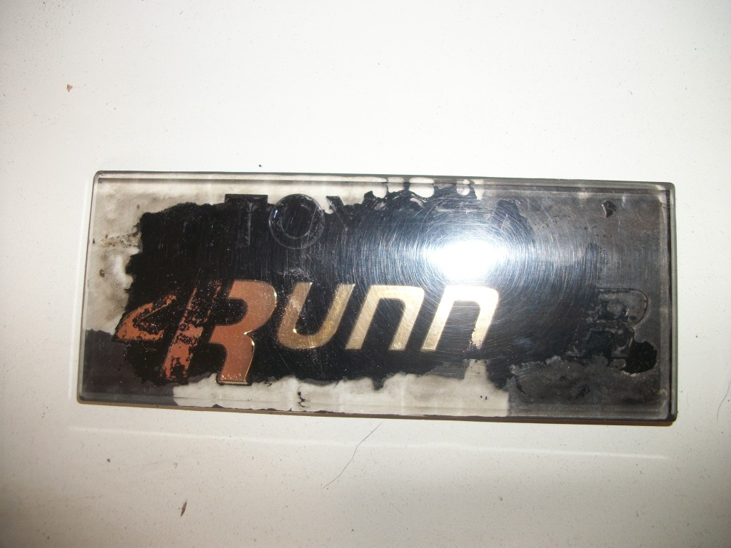

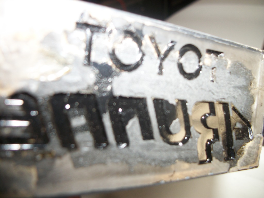

I've been curious for a while on how to fix these. Your info was correct. They are painted on the back, not plastic inserts.
4Crawler has a great writeup on how to take the b pillars off. I used a flat screwdriver and plastic pry tools.
http://www.4crawler.com/4x4/CheapTri...ml#BpillarTrim
I used a tiny flat blade and plastic pry tool to get the emblem off the pillar. It's held on by a tenacious black foam tape. What appears to be delamination is black paint wearing off. The words are engraved in the back of the plastic and then gold leafed or painted. I will someday go to a craft store and get silver and gold leaf and try to fix it. Not this week. Here are some pix:

Thanks for the clear pics! Seeing the back side of the badge I think a DIY resto is a fairly 'easy' undertaking. Is there any reason you would have to take the b-piller off or can you simply pop the badges out?

You don't need to take the B pillars off. I had already taken them off with the objective of getting the whole truck painted. My 4Runner came to me very clean thanks to loving former owners. But there were a couple of mysterious cocoons living under the pillars and the rubber vents need to be replaced as in 4Crawler's write up. The emblems are held on by that black adhesive foam tape Toyota uses for emblems. It was hot so they were heated, I wouldn't do this in cold temps. The look I thought was delamination was simply the foam tape getting old and pulling the black paint off with it. The "Toyota" letters are silver, the "4Runner" letters are gold. Next week I'll get the stuff to paint them. The emblems are a small detail that seems to bug a lot of people. Up to a couple of years ago you could still get them from Toyota for about $79 a set.
