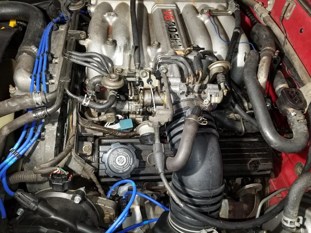

At my wit's end with this thing and need some suggestions on which way to go, it's been down over 2 months now and I need to get it fixed.
Problem: The engine turns over and fires, RPM starts to rise then quits firing but continues to turn over. If I keep turning it over it doesn't fire again but if I recycle the ignition it fires then quits every time.
Recent maintenance: Originally I had a coolant leak at the water bypass (but otherwise it ran fine, no issues) which forced me to remove the plenum. While I was in there I replaced the injectors (178k) with the 4 hole 'flamethrower' type and replaced the valve cover gaskets and the sensors on the water bypass. Put it all back together and it did exactly what it is doing now. Tore it down and put in a new tested set of the same 'flamethrower' injectors, this time used a light bead of red RTV at the plenum and throttle body with the gaskets to ensure I had no leaks, used a thread on this forum to make sure my vacuum/fuel lines were correct (still a bit sketchy that they are right), replaced the intake duct that comes off the throttle body as it was cracked and leaking, reset ECM again, but still have the exact same results. I removed a spark plug and cranked it and fuel shot up the fender so I'm getting fuel. I checked codes but it isn't throwing any. I sold the original set of 'flamethrower' injectors and as far as I know they worked fine, he was putting them in a couple weeks ago and was supposed to call me if he had an issue. I also did a tune up on it less than 3k ago; plugs, wires, rotor, bug. I took some pics in case someone spots something simple I missed or got wrong but at this point am beginning to think it may be a problem that just happened to surface at the same time but is unrelated to the work I mentioned above.

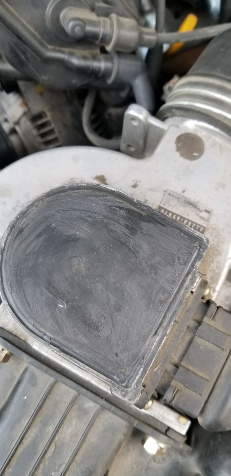

"Starts and runs then quits in a few seconds" is the classic sign of a VAF-COR problem. Very easy to check; jumper FP to B+ on the diag connector. If that clears up your problem, you know where to look

Air flow meter. Cut silicone off around it there are two little pins that have kinda a points type set up when it starts monkey with them they have to close to make connection to keep fuel pump going try that

That's irreversible damage to the VAF. A few simple tests (already described) will tell you definitely whether the VAF is the problem at all. Without "monkeying" with it.
