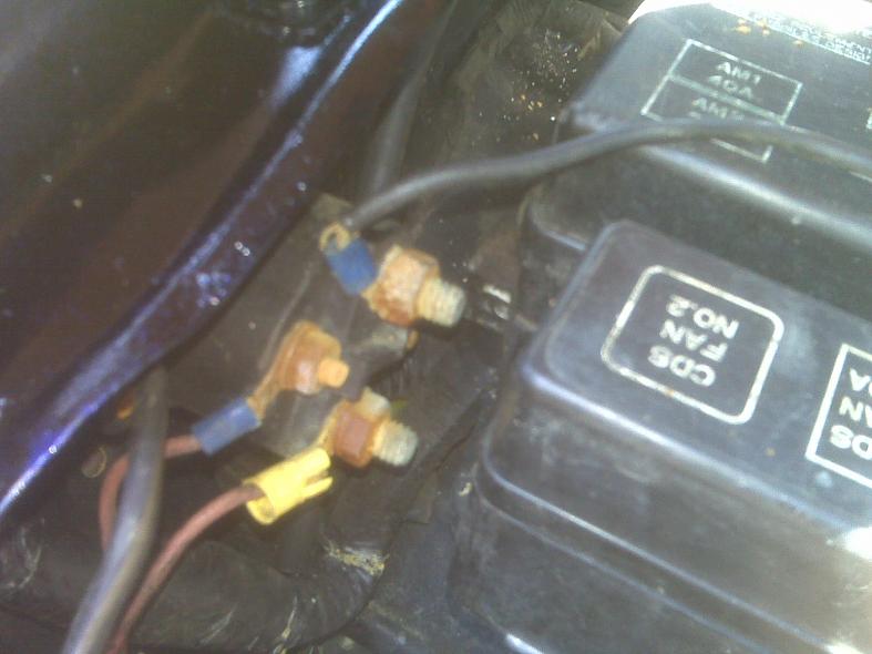

I have to really get on the gas to make it go. It won't go past 45mph/4k rpms uphill with the pedal to the floor. Truck only has 100k miles on it, but the previous owner didn't secure the battery which was rubbing against the power steering pulley, allowing the acid to leak everywhere. I'm thinking that because the truck has such low miles, it is highly unlikely that it's an internal trans problem and more electrical or vacuum related because of the acid which has corroded several wires. There is this solenoid next to the relays that I Can't quite figure out what it's for. The FSM doesn't list it, so I'm not sure if it's aftermarket. Everything in the truck seems to work, so I'm thinking it has something to do with the transmission. Here's a pic of it, so does anyone know what this thing to the left of the relays is?

Trans is definitely slipping. Does it on the flats too. Can anyone tell me what that thing is in the pic?

I am not sure what it is, but those wires connectors sure don't look stock. They look like those crimp on wire splices that you get at auto stores.
Did somebody add foglights to the truck? I wonder if maybe it is a foglight relay.

Yeah the wires aren't stock, but I wasn't sure if the relay was. Found some wires out front and they seem to match up with the wires that were coming from the relay, so they were probably for the foglights. Thought maybe they had something to do with the transmission because none of the wires are connected to anything and everything else works.
Going to go over the vacuum lines and wiring, so hopefully I will find something.
