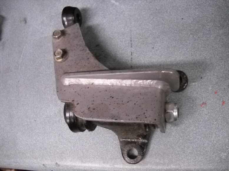

Downey Gusset 2wd Toyota truck idler arm
Hello
I didnt have time to do the front suspension myself..I had another guy I know do it...I will get pictures itr went pretty smooth car handles 100% better...
I recieved my gusset for my idler arm for my truck..Saying it was a PITA to put on is and understatement..Im wondering if this is even the right part? Has anyone else had problems..

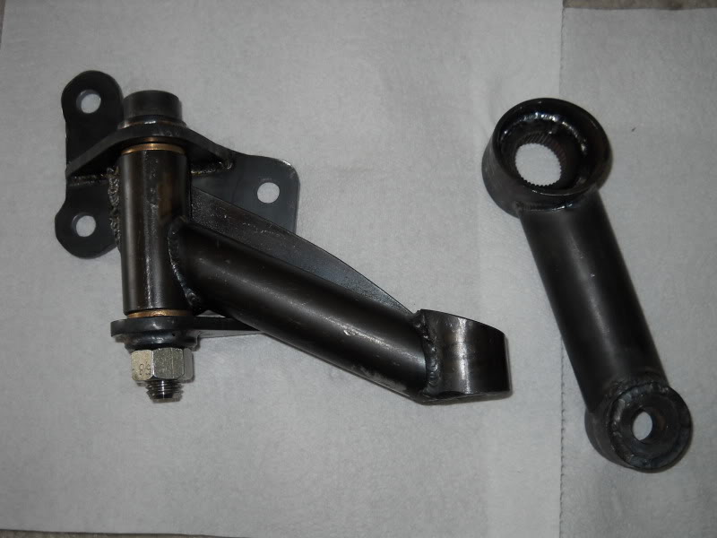

Here's mine:

I have the 2wd drive version from Downey. The fit isnt that good and the metal piece pressed up against drag link ..It did not want to go on..I dont think my idler arm was bent or damaged..I did have to take the front wheel off to put on the gusset..Was not a fun not so sure if its really gonna help ..i have to take some pics you tell me what you think..

Thats what Im talking about it really needs to be modified to fit correctly. I need to find someone that can do that for me..
I think Im going to take it off this weekend have someone look at it..

2WD Downey Gusset
Hello
I finally modified the Downey Gusset to fit properly on idler arm. I dont know who designed it..IMHO its a terrible design and fit for 2WD truck..
I Also had to make the holes bigger inorder to put the bolts through..I know with aftermarket its a "gamble"..I thought it would have been better than what it was..
