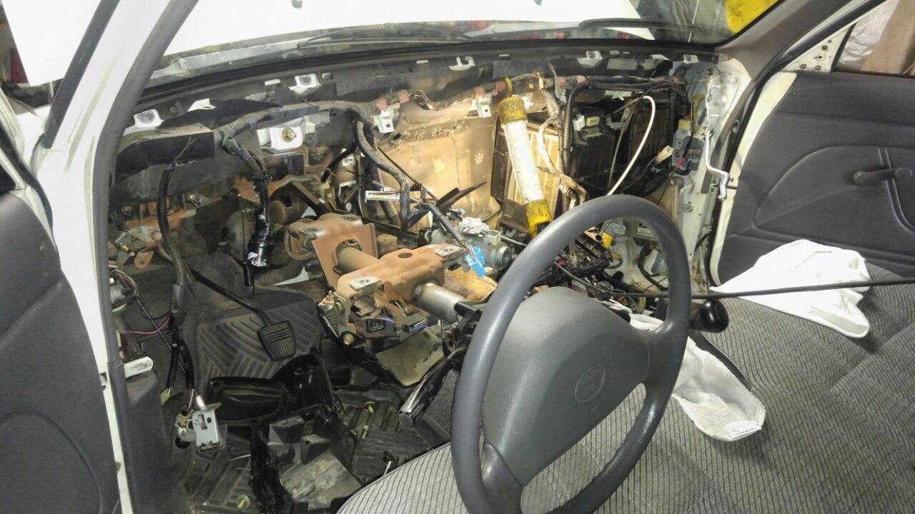

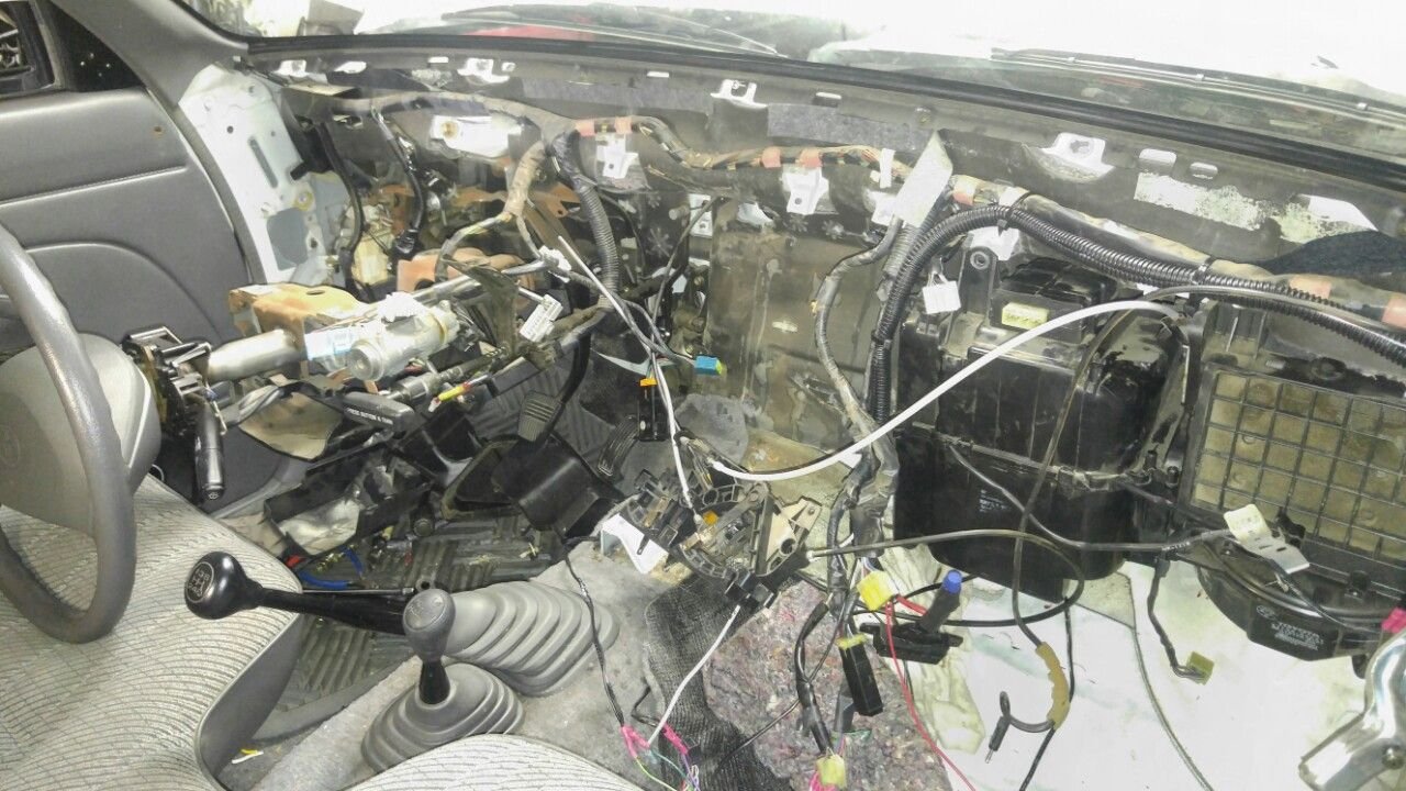

It is a job I never want to do again so I made sure to buy another OEM one:

Yep, that looks very familiar.
