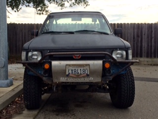

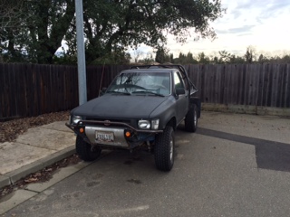

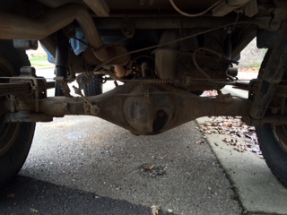

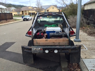

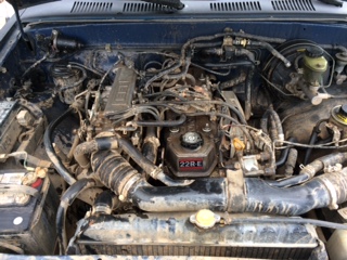

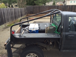

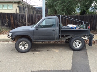

so i got this for $2500 and am slowly fixing it up so far i have put new tail lights (the previous owner bailing wired on the factory lights) i changed the clutch and ive put new tires on it. i have a crap ton of electrical problems that im slowly sorting out and i think most of them are from the blinker/light/windshield wiper module but thats soon to be figured out and i need a new rear end i have huge gouges out of my axles on both sides and the drivers side is from a toyota dually but i would like your feedback on what mods i can do to it to make it more trail worthy and to increase cargo space because this is my work truck as well as my trail truck and i have alot of work stuff for construction but i need ideas for cargo space im thinking of custom building a lumber rack with a grate over the cab for storage kinda like a safari rack i also would like to
-make half doors from the current doors and put the doors with wing windows on
-put a light bar or three
-cb radio
-steel rims
any ideas welcome thank you! sorry for being so long this is my first post

You got your work cut out for you man, but i appreciate you trying to keep an old Yota rolling.
The basics are clearance, traction, armor, and water tight storage. A little lift, some lockers, skid plates and sliders, and XL ammo cans could be a good start.

Allpro Offroad and Badlands make things like this, but if you can bend and weld some tubing you can save a lot of money. Anyway, as you mention, a similar and sized-up frame rack might help maximize the utility of that flatbed (and you can sleep up there so that taking a late-night wee is extra difficult!).
In Australia I saw thousands of Hiluxes with aluminum "tray" beds rated for HD loads. Some of these had folding sides that converted the tray from a flatbed to something more like a regular pickup box. So, that's an idea, too.

Many directions you could go. I suggest you take a look at the Official Toyota Flatbed Thread over on Pirate.
Personally I'd likely chop/modify the roll bar section so that I could hold lumber up top since it's a work truck - the version linked above would be a good place to start for inspiration.
I would also try to use up that dead space under the bed, in front of the rear wheels - I'm sure you could mount some lock boxes in those spots. Maybe consider "bedside" tool boxes and see if you can flank both sides with locking storage. Lastly, something I've seen on a lot of flatbeds - consider platforming across the top of the taller fender sections so everything is flat across the top, then put drawers under it so you can use that cavity for storage underneath. Obviously this will increase your COG for whatever types of loads you carry.

thanks for the ideas. i am planning this weekend to meet up with a friend who works at a saw mill in town and he wants to get the welders there to custom make a lumber rack and mabey some rock sliders and some boxes for me and weld it to the truck so we'll see how that goes and he was thinking about getting a tool box/ gastank combo for me and bolt that down somewhere but we'll see what happens and what ideas the welders have. i like that sleeping up top idea i havent thought of it. i would like to make some sort of awning for it off the side for camping and for sitting under at lunch when theres no shade and its 115 here but im still looking at ideas for that

when i change the rear end im planning on adding another leaf spring because with my current tools in it my leaf springs are almost flat and sometime im going to upgrade to old man emu or blitzen shocks and steering stabilizer or is there anything thats better or more highly reccomended? ive kinda given up on how much money i want to spend on it and i just want to make it exactly what i want and save up when i need to. and also any ideas for a second battery placement and what alternator i should get? you guys have been super helpfull already thank you

On my '94 I built spring packs out of craigslist and junkyard parts, sanding off rust and repainting each leaf. I think I had to buy the little slip tabs at a store. That worked great and I could easily have added an extra leaf. I used Bilstein HD shocks and they were fantastic. I used an OME stabilizer that I got a deal on, and that too was an amazing improvement over stock. Finally, I had OME torsion bars that I fond on Craigslist for cheap and I would recommend them.
On my Tacoma I just went all OME since I needed to replace all suspension. My springs are regular duty and IMO slightly stiffer than the stock springs on my '94. In your case the HD version would probably be the better choice (though I dont know how much your tools and boxes actually weigh). The flex on the springs is so-so--comparable to stock.
