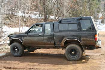

This much I know is very true. I bought an identical truck to yours (except the tires and 2" lift (same miles, truck, BL, etc.) and have had it for 5 years now. The motor itself has not had any problems. My odometer has since stopped, but I'm guessing there is about 300,000 miles on it by now.
