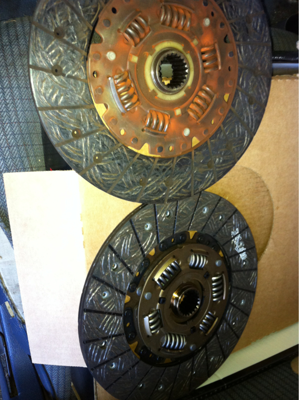

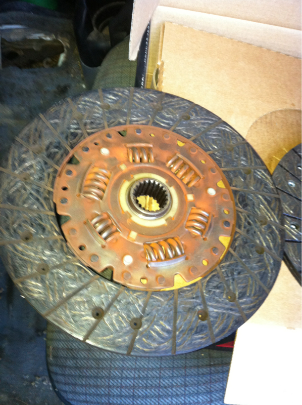

This morning I took out my clutch because I thought it was the issue since its got 110,000k on it and it looks like this
Any helpful hints would be greatly appreciated and I didn't see any cracks in the clutch pedal bracket
