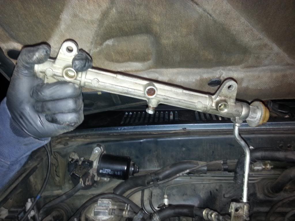

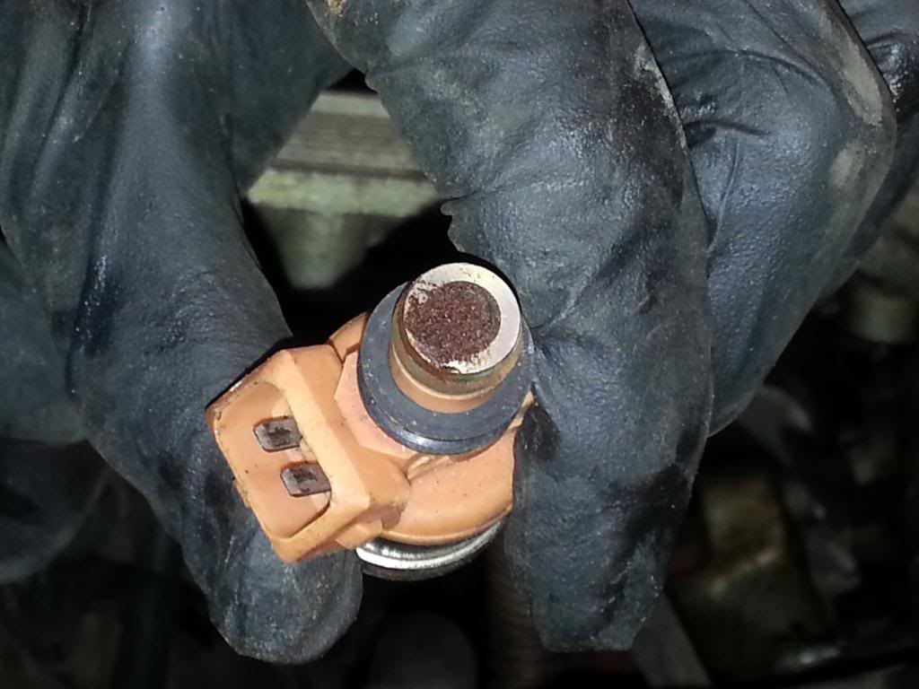

Old Jan 31, 2014 | 07:14 PM
  #22
sphealy's Avatar
Joined: Jan 2014
Posts: 241
From: North Carolina

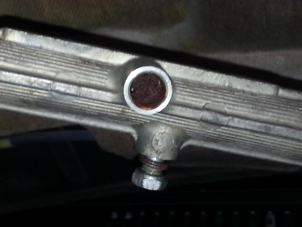

Old Jan 31, 2014 | 07:15 PM
  #23
sphealy's Avatar
Joined: Jan 2014
Posts: 241

Wow...Whats the filter look like? Usually rust from the tank will get caught in the filter, I have never seen a fuel rail look like that.
Old Jan 31, 2014 | 09:25 PM
  #25
Gevo's Avatar
Joined: Sep 2013
Posts: 1,631
Likes: 110
Yah. Im very curious what the filter is doing. If you can take it out and cut it in half to share for eduvation, that would be great
