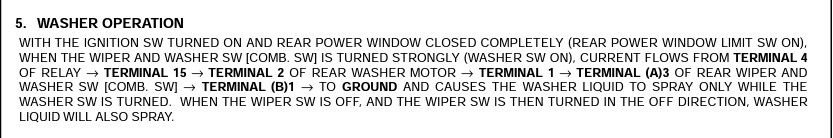

90-95 rear wiper wash motor
Well looks like they made it not so simple. It uses the rear window control box instead of a simple switch.
