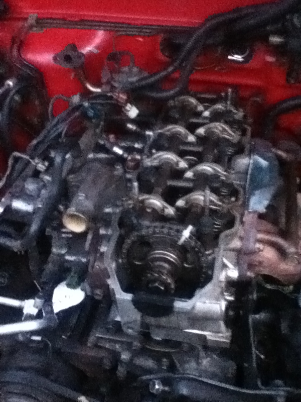

Rebuild coming along. The head gasket kit I got didn't come with a rubber o ring for the metal pipe that connects to the back of the head an bolts up to the intake. I was lost because I thought that metal pipe was supposed to have a gasket on it before you bolt it up to the intake. I could not find that here on the forums no where so just letting anyone know that. If your doing a gasket job on a 22re that metal pipe that bolts to the bottom of the intake doesn't have a gasket. There's a rubber o ring that seats in the bottom of the intake.

I am assuming you are talking about the metal pipe on passenger side, above the fuel filter that connects to the intake. I get my O-rings from Oriellys. They have a selection usually behind the counter in a red box. You want to make sure that pipe is sealed well. It is a royal pain to fix if it leaks and when the motor is back together.

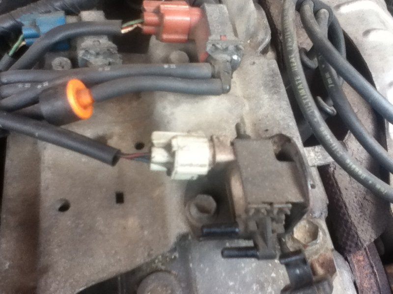

Thanks OSV! I was wondering about that. My truck is running alright but has one Issue. Here's a pic of a plug on top of the valve cover which is White on that plug there's one vacuum line coming out the back. Where does that hook up to. When I took it for the first drive yesterday when I pulled up to a stop sign. The motor would shut off? Other then that it runs fine.

I believe that's your ac idle up vsv. It should have two hoses attacked to one side the other end should be breather (no hose) but should have a cover over that end. Google 22re ac idle up or vsv and you'll see what I'm talking about.

there is also an idle up plugged into the plenum? that's not it tho... i'd search for a vacuum leak for that dying problem.
