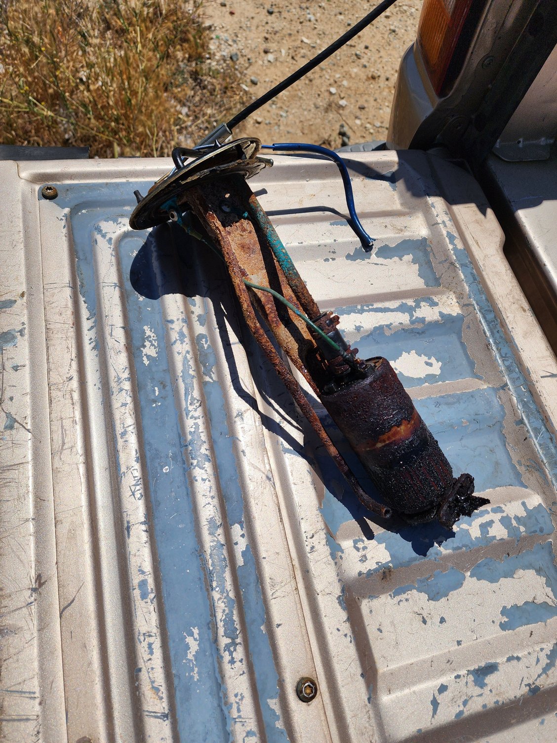

He wanted to get it going so I took it on and started working on it. In short, the fuel tank, pump, hanger and sending unit all had to be replaced (found the hard way you cant get a sending unit with a dummy light for a 19 gal tank anymore)
Old fuel pump
Old fuel pump

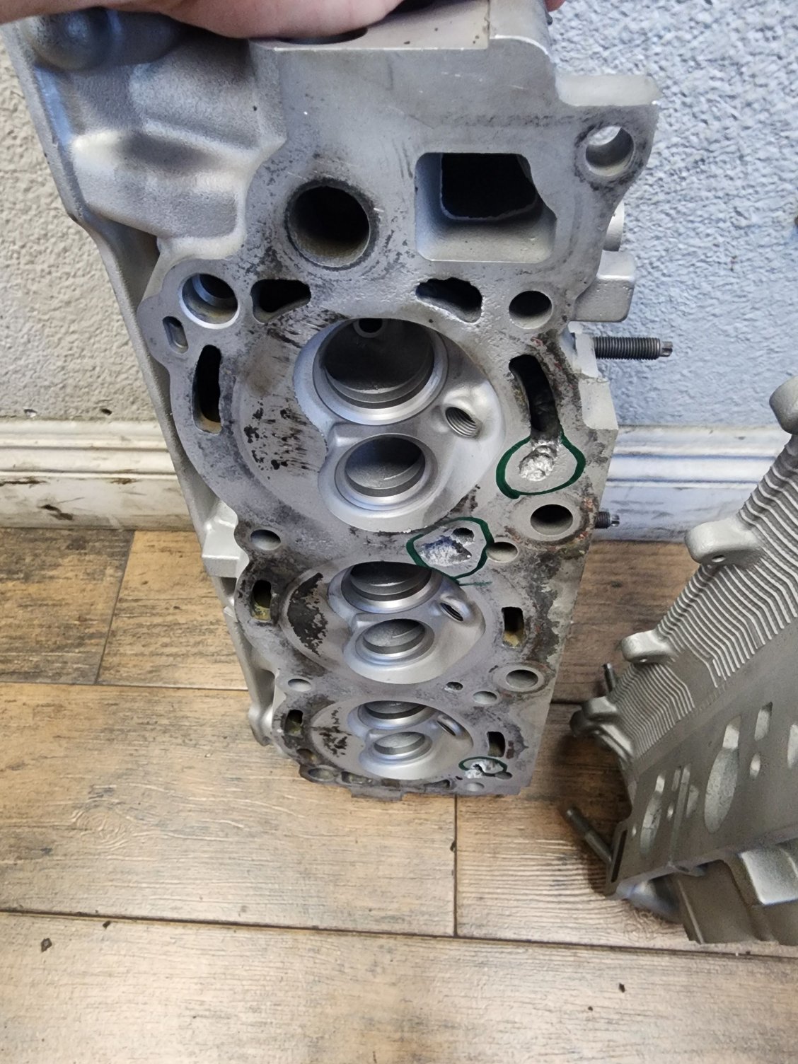

After this, did plugs, wires cap n rotor to get it fired up and make a determination to carry on. It fired up, I rev'd it a couple times and shut it down. Sounded ok and decided to do the rest of the maintenance. Cooling system was pretty bad and evidence of head gasket seepage was found. Decided to do head gaskets, water pump timing belt, etc. Pulled the heads and they were so pitted, it wasn't advantageous to weld the pits and machine, so I had the machine shop source some heads.
Old head
Old head
Slapped the rebuilt heads on and reassembled. Starting it up, it definitely runs sluggish and is incredibly hard to accelerate (i cant get it out of 2nd gear because it wont build momentum). Addmitedly, I have no idea what it was really like before I tore it down. Aside from the new fuel pump, heads, timing belt, water pump, ignition components. etc, I did replace the distributor with an Amazon cheapy because the wiring had a bit of damage on the old one. I have: re-checked my timing to make sure the belt didn't skip a tooth, set base timing to 10° BTDC (it seems to buck at 10° *sometimes*) checked for compression, all are at 125psi, checked the VAFM and TPS. Used a cheapy tester to check the injectors and sprayed carb cleaner through them. I pulled the plugs and for being brand new, has an excessive amount of carbon (gotta be running rich). I replaced the vacuum hoses and smoke tested through the brake booster port on the manifold. There's nothing really screaming at me that anything is wrong. The only things I haven't checked are fuel pressure or if that cat is plugged. This behavior occurs in open loop and closed loop (normal operating temp) I have taped off the FITV port in the throttle body as a test and saw a bit of improvement in revving it up. The coolant ports were plugged on the TB and I have cleared them out as well. Apologies for being all over the place, it just feels like I've tried almost everything and nothing has worked out for me. Also, you can see in the before picture below, the EGR vacuum was routed in such that it bypassed the switching valve. I have replaced the 3 valves on the passenger side fender well as before it was brought to me, it was pressure washed and some of the valves got damaged. So the vacuum is routed as per the diagram.

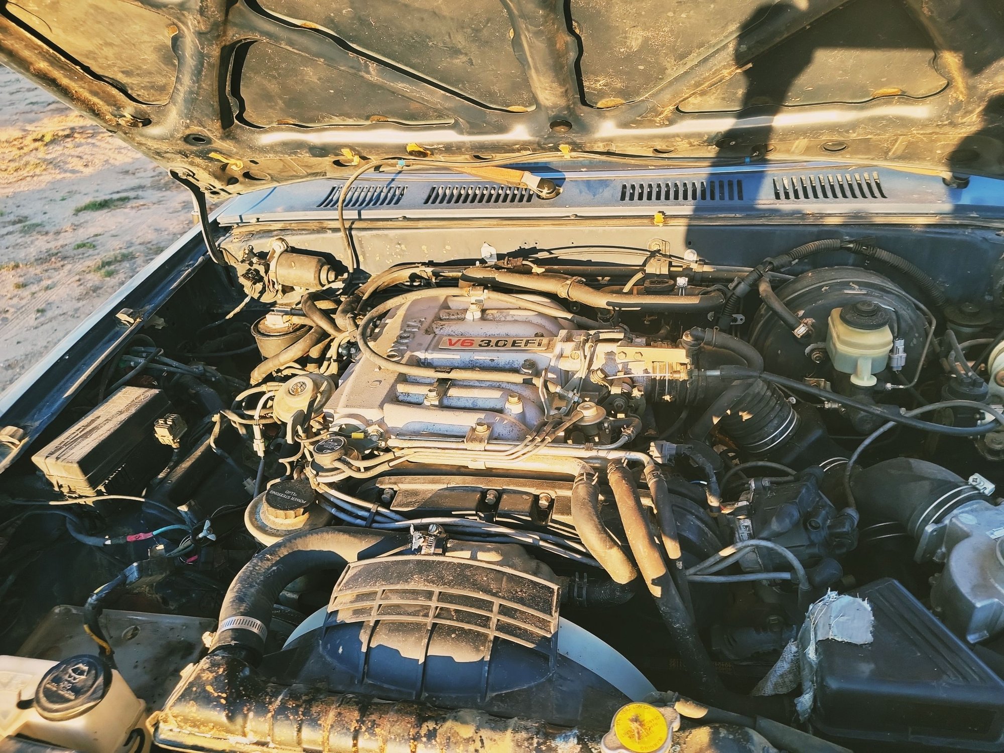

Before
Before

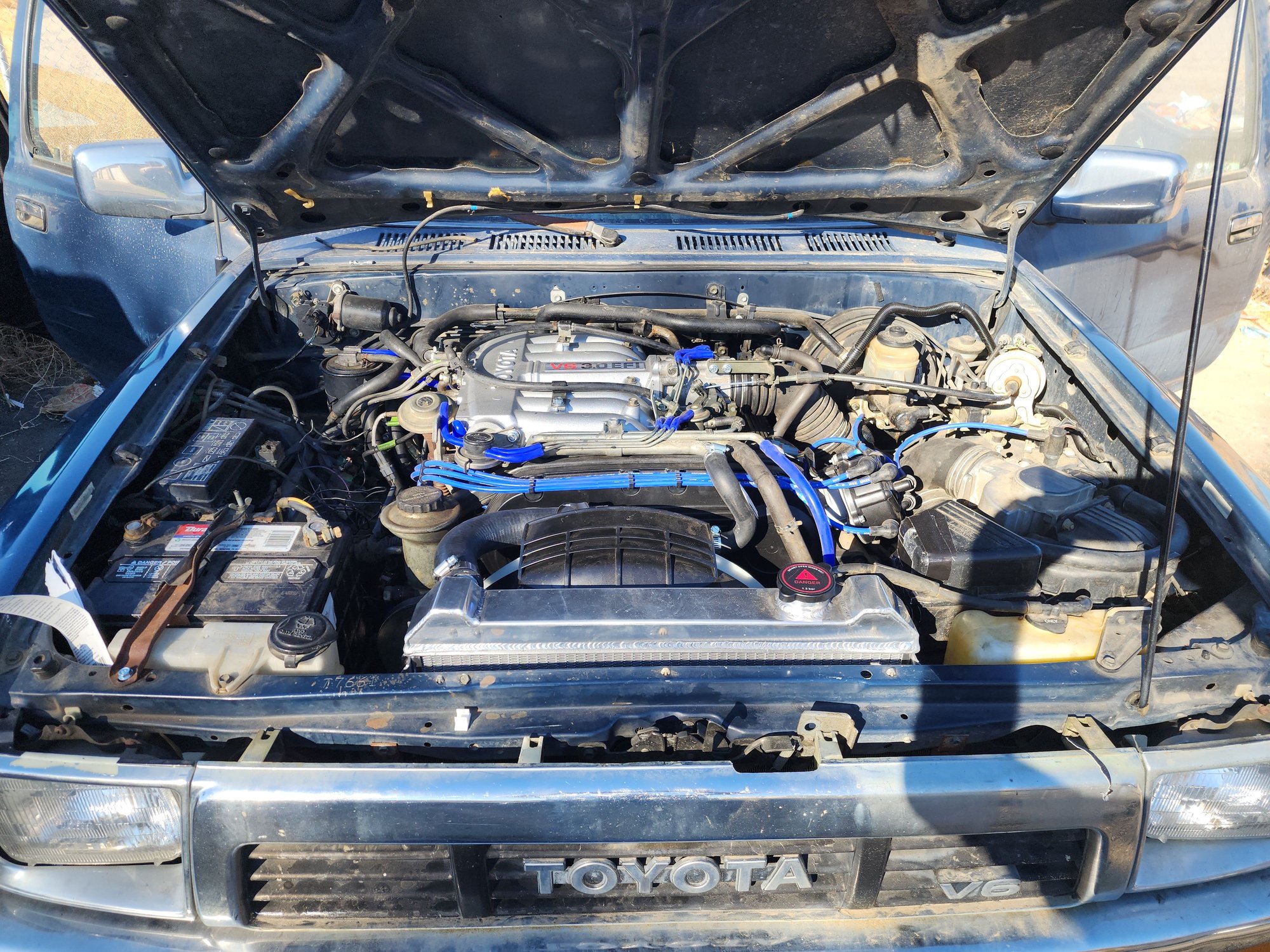

After
After

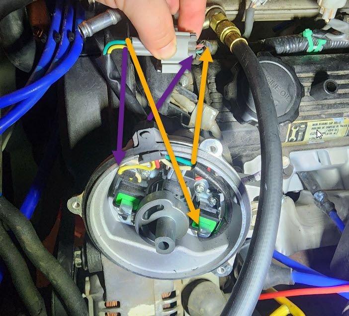

OK! So I am dumb. I checked the ECT at the wrong ECU ground. Checking correctly, I get corresponding ohms to temp.
I decided to pull the plenum an check the spay patterns of the injectors. I thought maybe I had leaking injectors. That is not the case.
I started thinking more about the distributor I bought off Amazon and I think the coils are incorrectly wired. All measurements are good but if the 22re dist layout for G1 and G2 coils is correct, then G1 signal is going to G2 at the ECU and vice versa. Does anyone have a distrubtor you can check?
If this can be trusted:
" White..NE signal
Red..G1 signal
Black..G2 signal
Green..G- signal"
and the 22re dist layout can be trusted (I have 3VZE)
Then I believe they are wired incorrectly. This would make the cam to crank correlation off by 180°. It would still run, but run like a dog.....
What do you all think?
