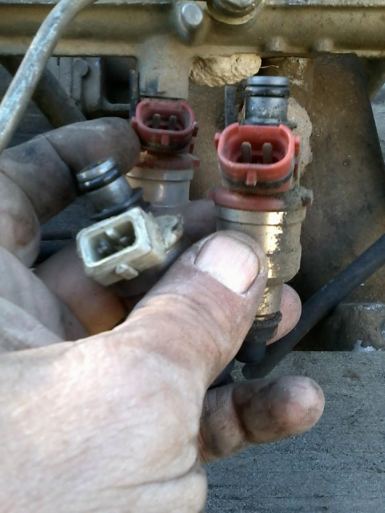

85-87 injectors have white tops on them. The 88 are a red top injector as the same as the 89-95 injectors are red as well but they are keyed different. You should not be able to stick an 88 injector into an 89 harness and vise versa even though I have seen it done. They each have a different resistance as well.

each diagram shows orientation of the plug connections

Here are the 3 types of injectors. The white one is 85- 87, the 88 looks just like the 89 and up but the fool proof tabs are different. I dont remember which one is which but 85-87 is 1.5-3.0 Ohms, 88 is 1.0-2.5 Ohms, and the 89 and newer are 13.4-14.2 Ohms. Do a resistance check to see which ones you have. Notice on the red injectors have a fool proof tab either above or below the pins that connect to the harness.

Like Terrys87 said the 1989 injectors were 13.4-14.2 ohms. That is because 1989 22re's did not use a solenoid resistor like the previous years. The 85-88 used a solenoid resistor because they were low resistance (1-3 ohms depending on year). If you are running an 88 computer and 88 injectors plugged into an 89 harness with no solenoid resistor that is why it is running bad. You need to run the right computer with the right injectors and with or without a solenoid resistor depending on configuration. What part number is your computer?
