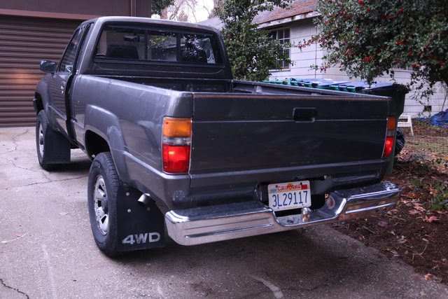

The new relay came in the mail today. I popped it in and everything now works as it should:
1988 Toyota Pickup Tail/Dash lights intermittent-y94lkjtl.jpg
