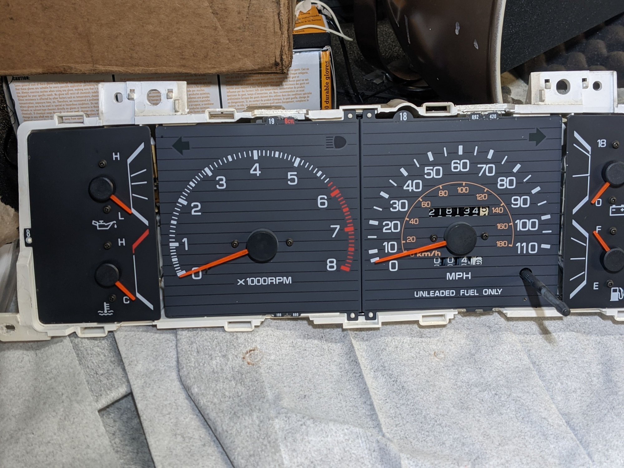

As I'm sure you can all appreciate: my glorious SR5 instrument cluster needles have been dulled by three decades of uv exposure. I decided to address this by repainting the needles myself. I used my dad's 94 base 4x2 needle as a color guide for the color I should use, while I know it's not exactly the same, I do like how it turned out. After spending a few mins at the Michaels hobby store I found my acrylic paint and thin synthetic brush and proceeded with the kraftwerk.
​​​​​​Finished product first:

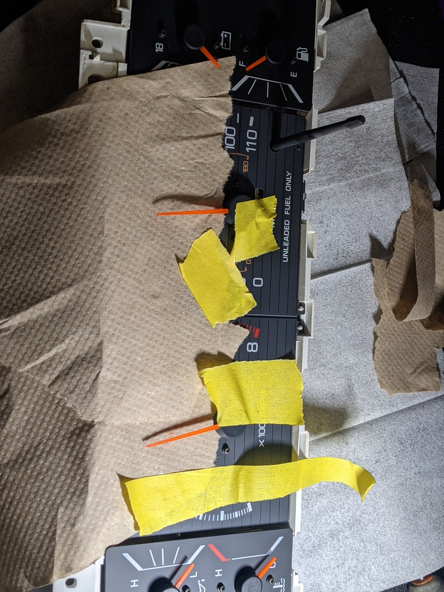

5. I put down some paper towel underneath all the gauges with some painter tape and taped the tach/speed needles upright to get a better angle with the brush.

All painted, being gentle with tape/needles
Looking good!

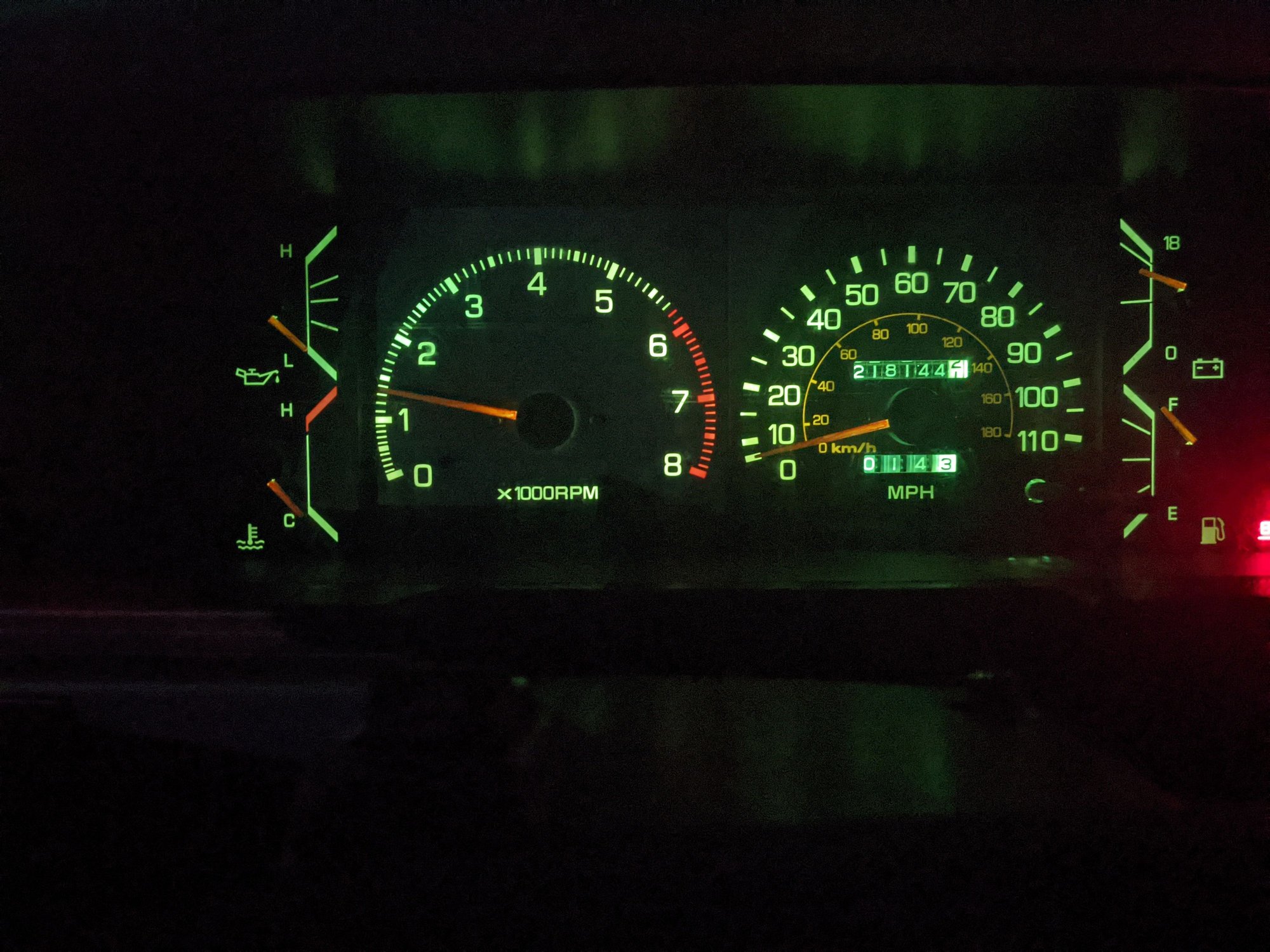

Whoops! Don't paint the sides of the needle, just the tops. I'm also going to try some 2W LED bulbs from Amazon to see if that gives it a little more clarity.

I should add that I did this yesterday, so today I went back at the needle sides with some rubbing alcohol and q tips to get the paint off the sides as best I could. The result of the new effort is the very first pic in the thread.
That's part of the reason I went with acrylic: it's a lot easier to get off and fast drying as well. Let me know if you have any questions!

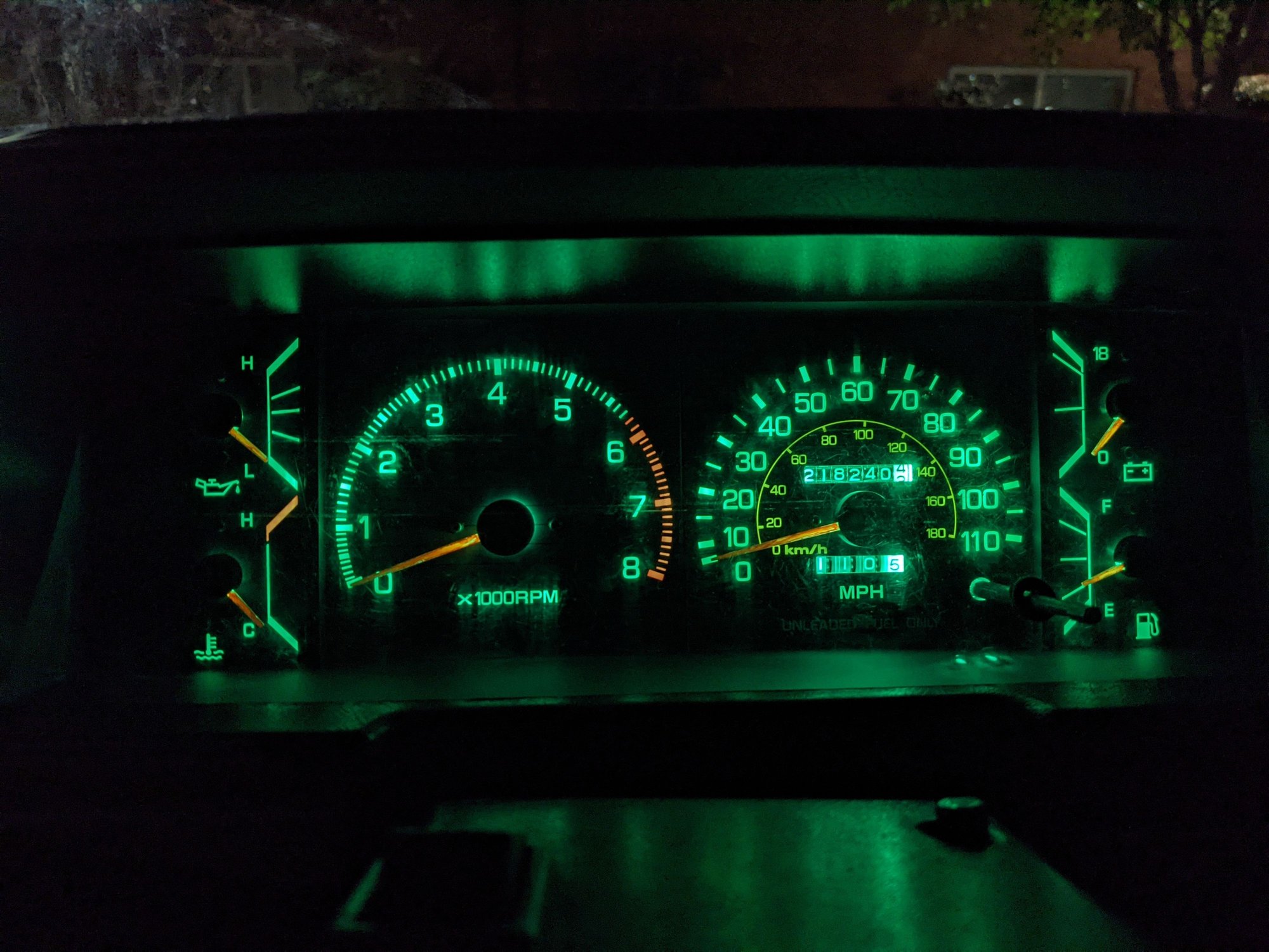

Final update with the LEDs!

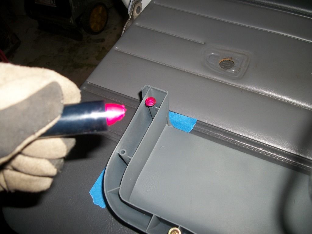

Yeah. Don't over look nail polish, nail polish remover (acetone), and lip stick for various detailing. I used gold and silver nail polish to repaint my B pillar emblems and polish remover to clean them. I used lipstick to mark where to drill holes for door pockets. Excellent job OP! I love the attention to detail. I've been irked at my gauge cluster thinking the needles were faded red. Turns out they are supposed to be orange.

I was thinking about it, and now that I have the LEDs in place they've illuminated the brush strokes I had from my work with the acrylic paint. I thought maybe the nail polish would be a little too corrosive on the 33 year old plastic needle? But I may eventually redo it with nail polish because I think that would do a better job of eliminating the brush strokes. "We're experiencing levels of perfectionism that shouldn't be possible" lmao 😂
