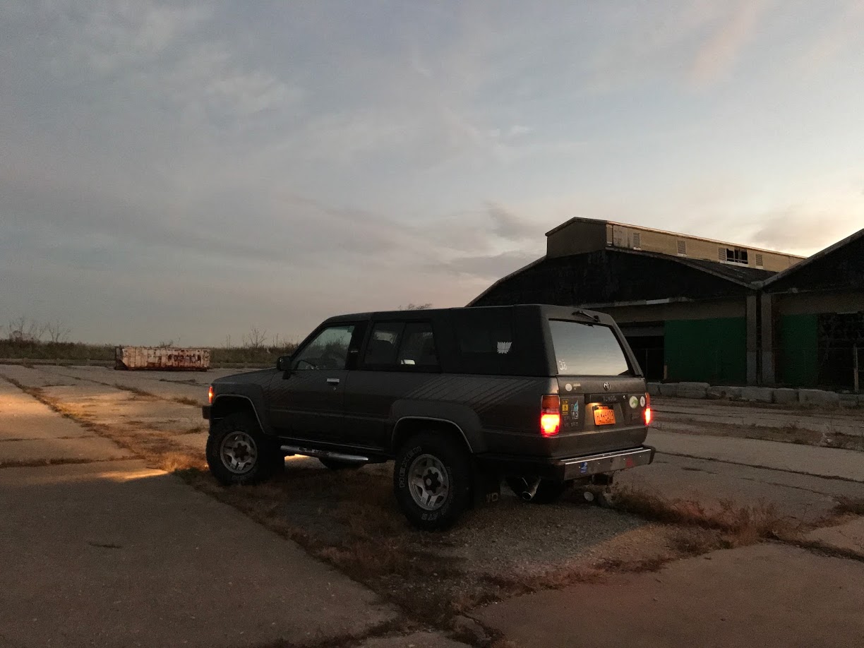

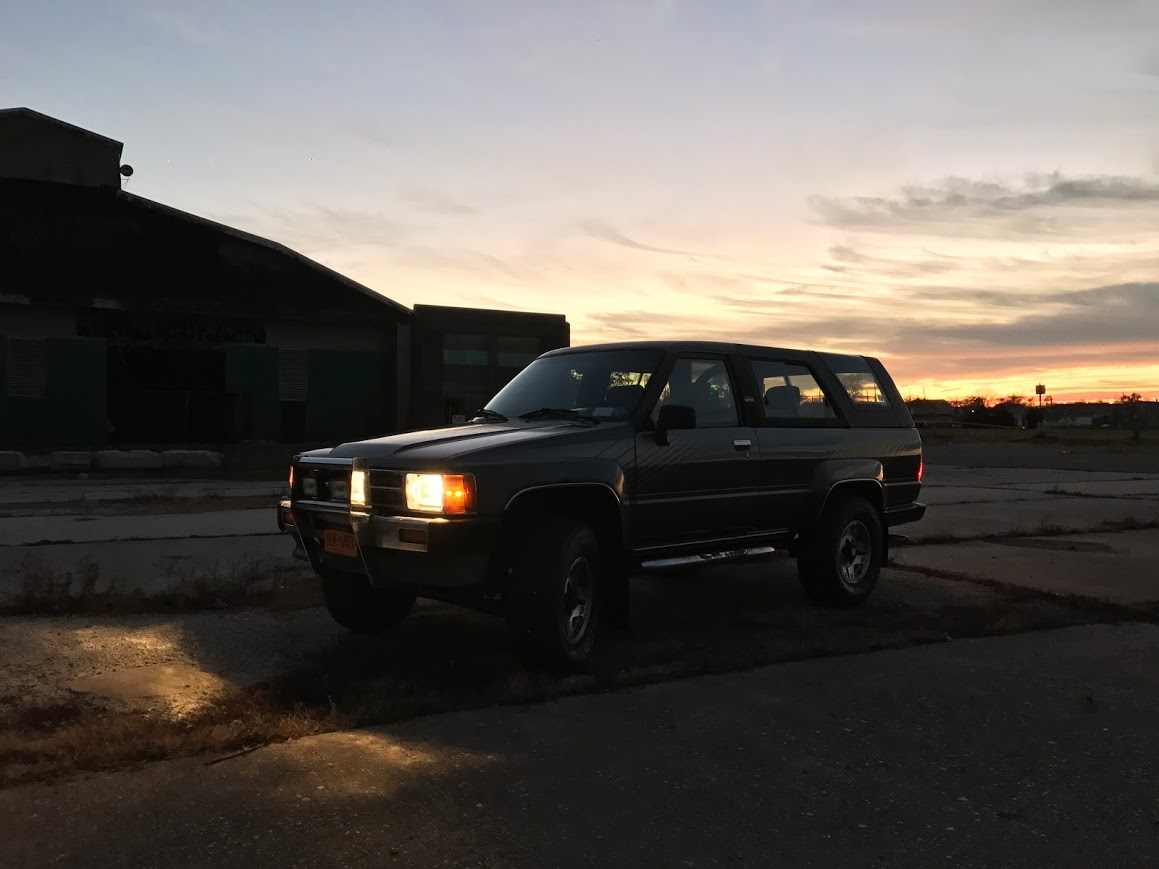

Hey YOTATECH members! I've been lurking this forum for a couple of months now and I have a couple of questions! Please help!
I just picked up a 1988 4runner with a V6 3.0 engine. After buying it for $2900, I'm starting to have doubts.
1) Its my first car and I'm not very mechanically sound. I am learning though.
2) Its the V6 3.0 engine and the MPG sucks! Also, it has alot of white smoke coming out of the exhaust when I first start it up. DOES THAT MEAN THE HEAD GASKET IS GOING?!
3) Is this thing a money pit? I saved up all my money for it and barely make enough for the insurance and gas.
4) It has no frame rust what-so-ever but it does have a small rust hole and some bubbling on the left and right fenders
5) Small oil leak. Going to put the STOP LEAK (Lucas Oil) products in them to see if it works.
6) The L trim on the right side has a lot of rust that I plan on sanding down and painting over.
It is beautiful though. Interior is super clean. Ever electronic works. All windows. Heat, AC. The back seats feel as if no one ever sat on them! Drives fine. Slowwwwwww though. 4WD is great.
Went up a sand hill in it and it took it no problem. That was fun with my friends LOL. Got an oil change. Replacing the fuel filter soon. Changed the timing belt. Changed the muffler and exhaust. The suspension really stiff but I think that is normal.
What do you guys think? Should I try to resell and wait until I graduate college and get a real job to try to find a 22RE one?

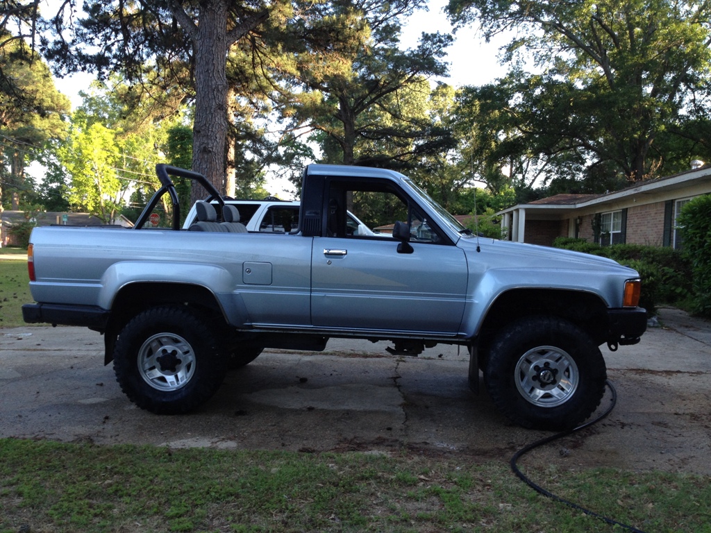

I appreciate that buddy! See if you can sand down that rust on your L trim and paint it. I've never offered it before but if you can't make it look right, I might consider pulling one off my spare top for you. Wouldn't have a complete top anymore but I like your attitude. Wait til this summer. You'll turn all kinds of heads when you ride around with the top off.
